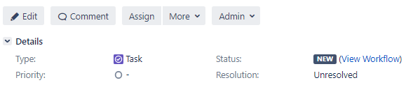

I am not able to change the status of some issues from new to any other status in a project.
I can change status of some issues with same issue type and having same workflow but not able to change few issues. project is associated with single workflow.
Below attached issues are from same project, issue type and having same workflow.
Can you please advise me if I am missing something ?

Hi @Sushmitha ,
As per the screen shot, you can see the transitions of this ticket. generally transitions are used to move any ticket from one status to other.
Are you trying to change status, with transition or any other option.
Sushmitha
June 29, 2022
Hi @Sreenivasaraju P ,
Thanks for addressing the issue.
Yes, transition is visible in 2nd attachment but not visible in 1st issue. Both issues are having same issue type and workflow.
