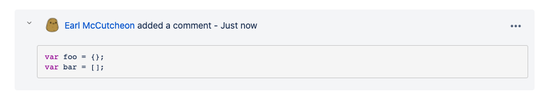

It will show up in the comment like this:

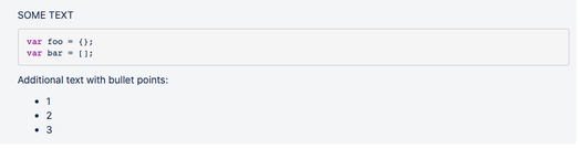

As an exe if you wanted to add in some additional text like the following screenshot:
Run a get on the issue and you will see the additional formatting as:
"body": {
"version": 1,
"type": "doc",
"content": [
"type": "paragraph",
"content": [
"type": "text",
"text": "SOME TEXT"
"type": "codeBlock",
"attrs": {
"language": "java"
"content": [
"type": "text",
"text": "var foo = {}; var bar = [];"
"content": [
"type": "text",
"text": "Additional text with bullet points:"
"type": "bulletList",
"content": [
"type": "listItem",
"content": [
"content": [
"type": "text",
"text": "1"
"type": "listItem",
"content": [
"content": [
"type": "text",
"text": "2"
"type": "listItem",
"content": [
"content": [
"type": "text",
"text": "3"
