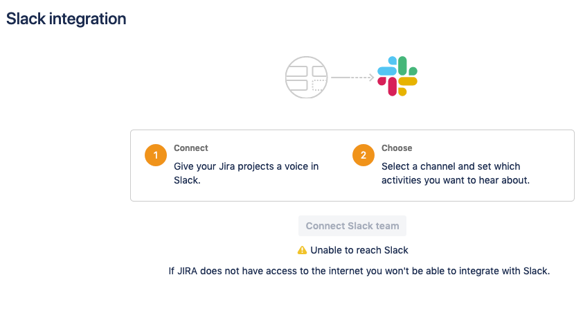

Hello,
I have updated my JIRA software to 8.1.0 version.
Now, the Slack integration is unable to reach Slack.
I have take a look in the console, and I have a 404 error on /rest/slack/latest/connection/can-reach-slack.
Is anyone else had this problem? Is there a solution?
Regards

We had the same problem. When i disabled 'Slack Connector for JIRA' add-on, which we used before, the problem was resolved.

Here's the REAL answer! :)
Had the exact same issue. After removing the old connector I had to disable and re-enable the new one.
