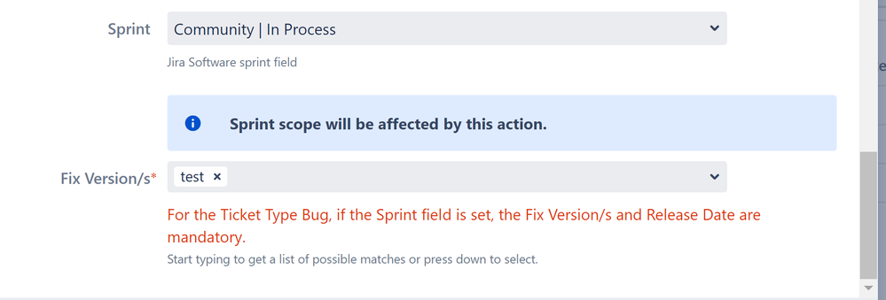

Hi Team,
def errorText = "For the Ticket Type Bug, if the Sprint field is set, the Fix Version/s and Release Date are mandatory. "
def sprintField = getFieldByName("Sprint")
def fixField = getFieldByName("Fix Version/s")
def releaseField = getFieldByName("Release Date")
def sprintValue = sprintField.getValue()
if (sprintValue != "")
    releaseField.setRequired(true)
    fixField.setRequired(true)
    releaseField.setError(errorText)
    fixField.setError(errorText)
 else
    releaseField.setRequired(false)
    fixField.setRequired(false)
I need to ensure that the "fix version" and "release date" fields are mandatory when the "sprint" field is not empty. I've attempted to achieve this using the following ScriptRunner behavior. When we populate the sprint value and provide values for the fix version and release date fields, it's displaying an error. Is there something wrong with this script? This script is commonly used in various scenarios.

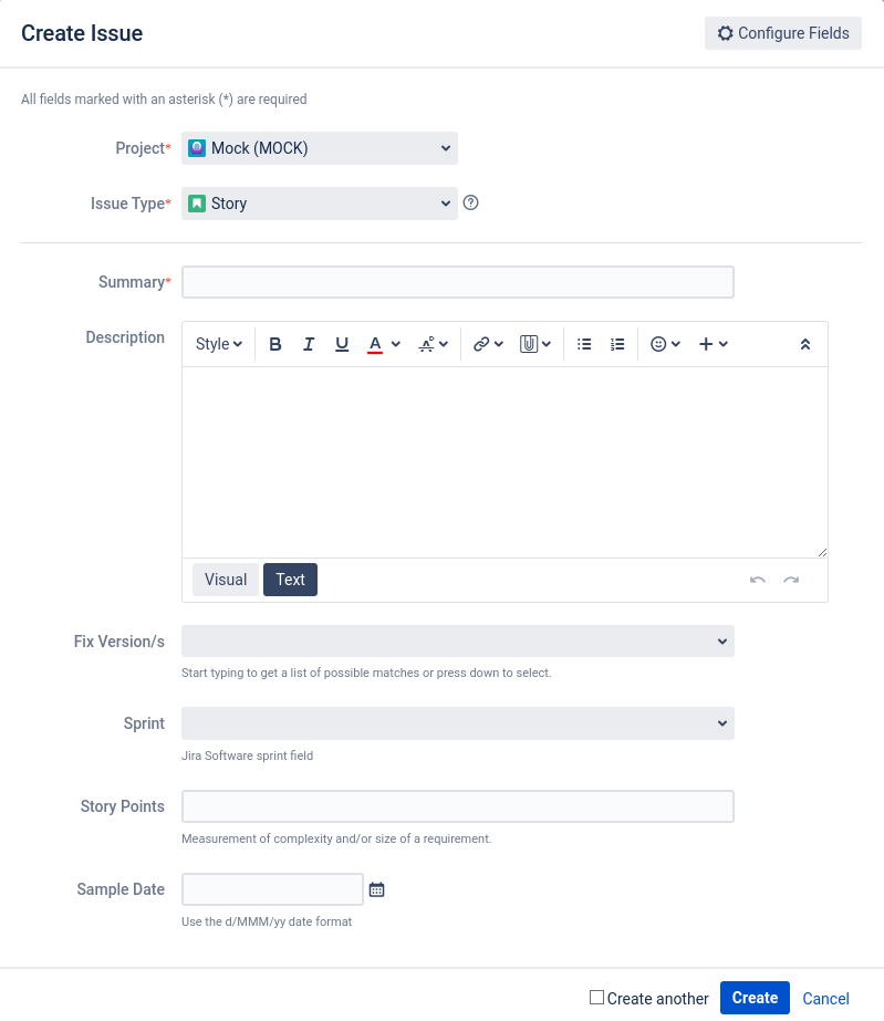

I am also including a couple of test screenshots for your reference:-
1. When the Create screen is first loaded, and no value is set to the Story Points field, the fields are not set to mandatory as shown in the screenshot below:-

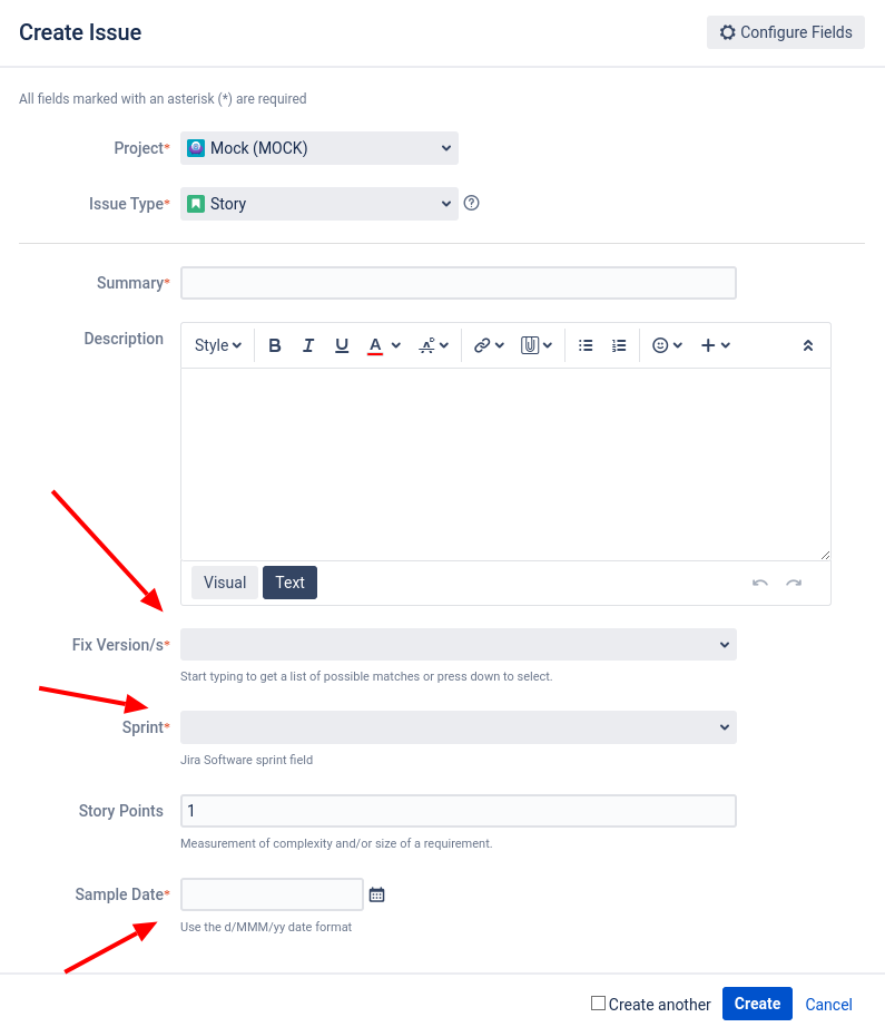

2. However, if a value is added to the Story Points field, the Fix Version/s, Sprint and Date field is set to required as shown in the screenshot below:-

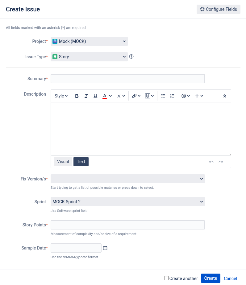

1. When the create screen first appears none of the fields are set to required as shown below:-
2. If the value from the Sprint list is selected, all the other fields will be set to required as shown below:-

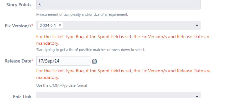

jira_admin_cu
August 19, 2024
Hi @Ram Kumar Aravindakshan _Adaptavist_ ,
Were you able to create the ticket ? its showing mandatory but its not allowing to create a ticket.

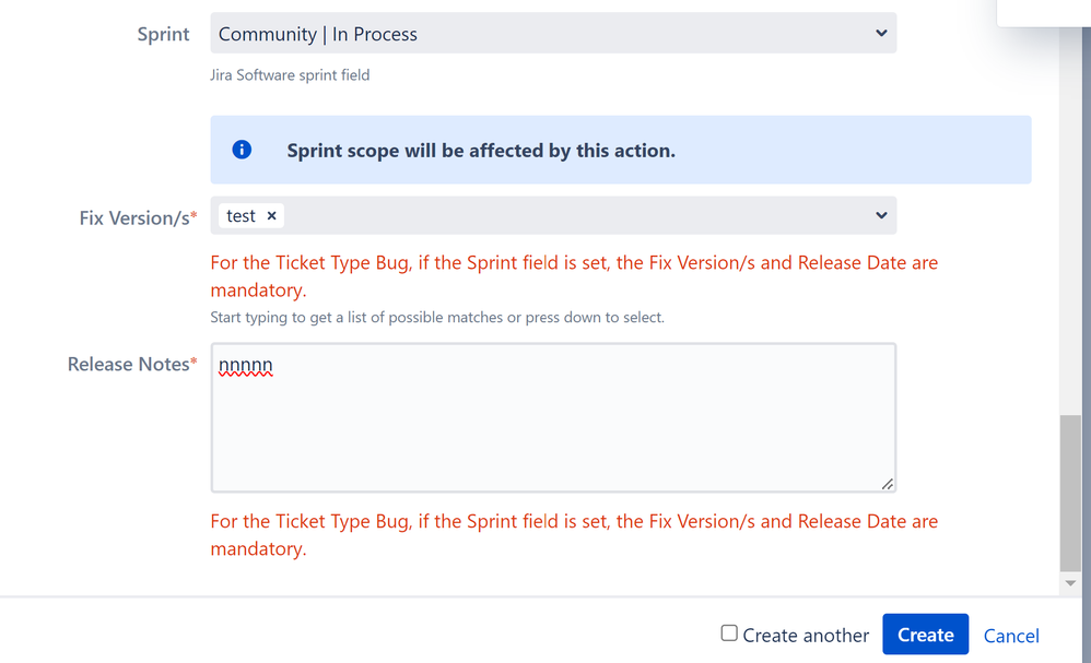

August 20, 2024
Hi @jira_admin_cu
I don't seem to be encountering this problem in my environment.
The error message you are getting suggests that you haven't updated the Behaviour code according to your environment.
From the screenshot you shared, the Release Notes field is set as required, but the error message indicates that the Release Dates field is mandatory.
Please double-check if your code is updated according to the fields you are using in your environment and ensure that all the fields that have been set to required have a value so the ticket can be created.
