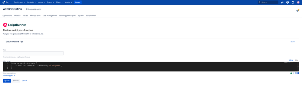

For your requirement, if you intend to transition any of your linked issues with ScriptRunner's HAPI, all you have to do is:-
issue.outwardLinks.each {
it.destinationObject.transition('In Progress')
Please note that the sample working code above is not 100% exact to your environment. Hence, you will need to make the required modifications.
Below is a screenshot of the configuration:-

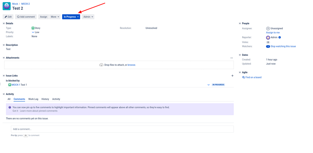

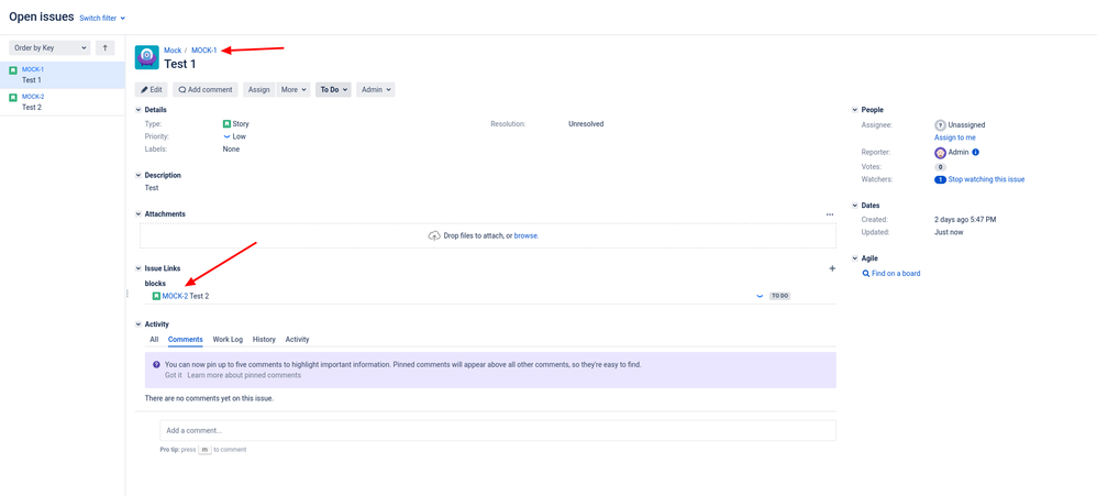

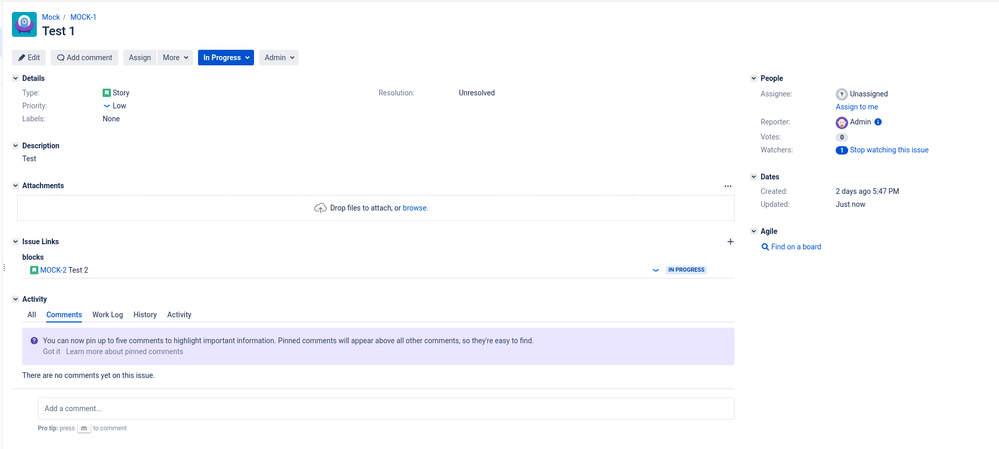

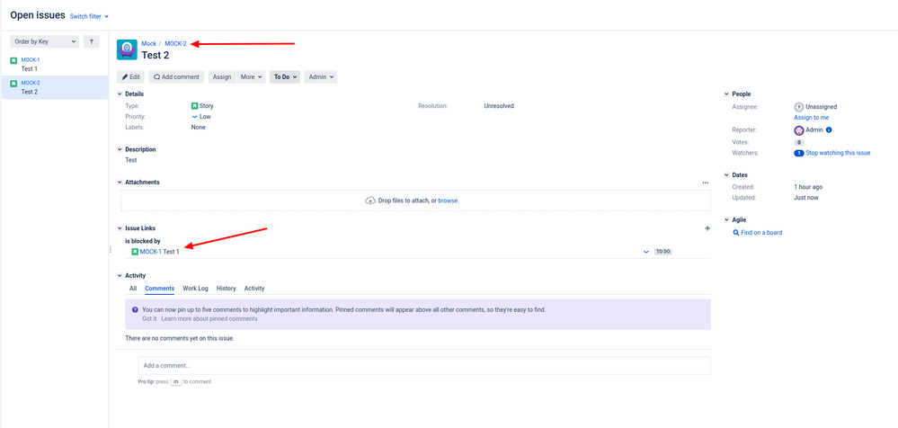

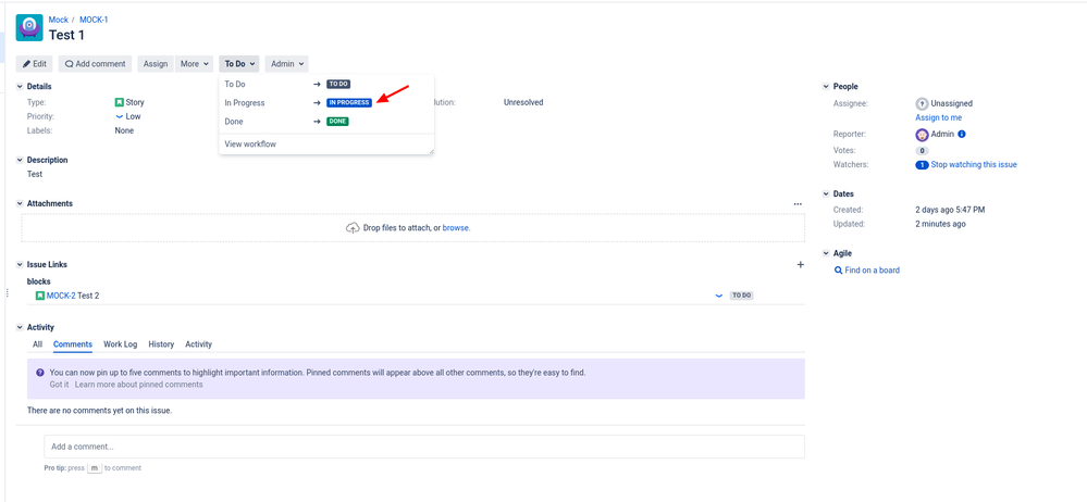

1. As shown in the first two screenshots below, MOCK-1 is linked to MOCK-2, where MOCK-1 blocks MOCK-2.
2. Next, when I transition MOCK-1 to In Progress, as shown in the next two screenshots below, as expected, MOCK-2 also transition to In Progress, as shown in the last screenshot below.
