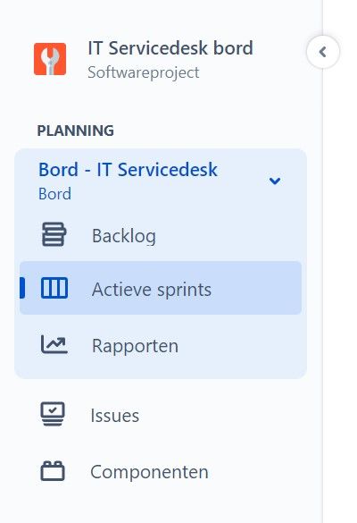

We have linked a Serviceproject to a Softwareproject, so that we can arrange our issues into epics and sprints.
But unfortunately on the Softwareproject the Roadmap isn't showing. I've read something about the filter settings. So I tried to change those, but then our tickets from the Serviceproject aren't visible on the Softwareproject.
Hopefully you can help me with some step-to-step instructions to make the Roadmap tab visible.

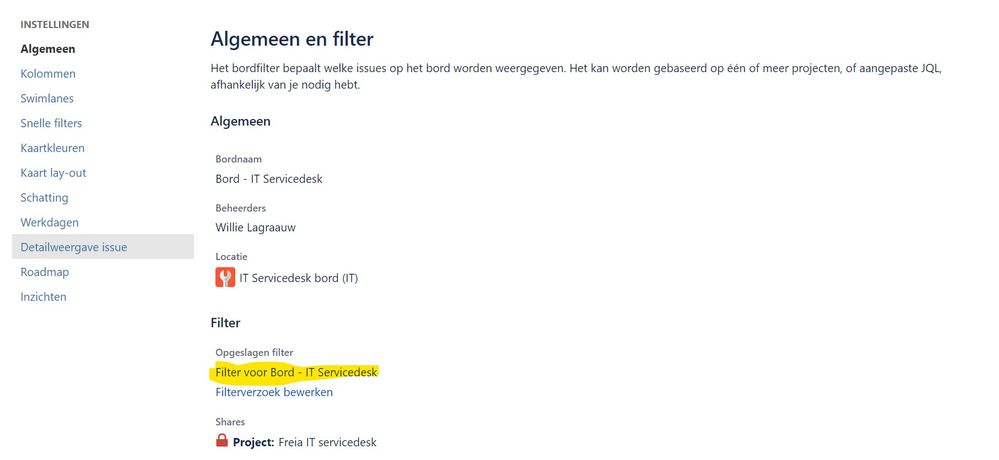

@Trudy P Claspill thank you for your quick reply. We also want that the board filter only shows the issues from the service project that is connected. I only don't know how I can change the settings, because when I change the filter we can't see the issues from the service project any more

With regard to changing the filter for the board, please show us the filter used by the board when it IS showing the issues from the Service project and then show us what you change it to such that the board stops showing the issues from the Service project.
We need to see the actual syntax/JQL of the filter. In your original post you have shown us just the name of the filter. The JQL will be displayed farther down on the same screen.

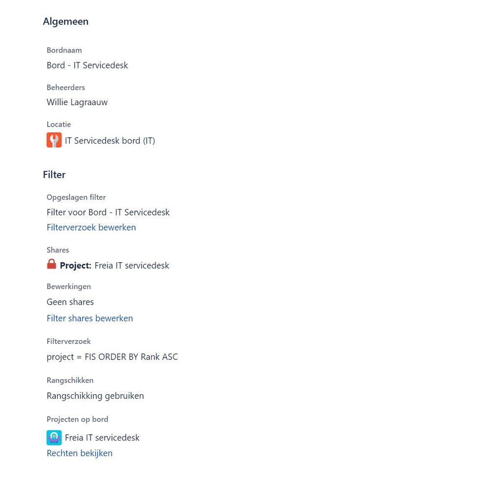

This is the information on the page where I can change the filter settings. But when I select another filter the issues from the Freia IT Servicedesk board aren't visible.

Thank you for that screen image.
From that image I can see that your filter is selecting information from just one project.
When I mentioned that you might need to change your board filter, I was referring to editing the filter JQL shown above. That will not be necessary in this case because it is already set to select issues from only one project.
When the Location for a Board is set to your personal Profile, the Roadmap option will not be available. I have not yet found documentation that states this, but that is what my experimentation reveals.
My experimentation also reveals that even though the board filter picks issues from only one project (your service project), when you set the Location for the board to another project (a software project) then Jira interprets that as the board being configured for multiple projects and the Roadmap option will not work for you even if it is enabled.
There does not appear to be a method to create a board for a Service project and also get the Roadmap feature.
