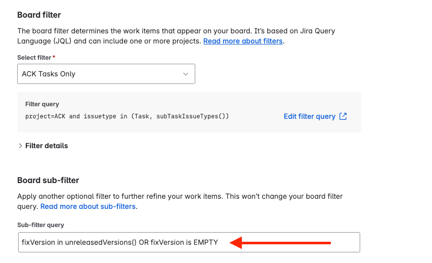

In your Board Configuration check if there is a Sub-Filter defined.
Are the missing items within the scope of the sub-filter, or are they excluded by the sub-filter?
