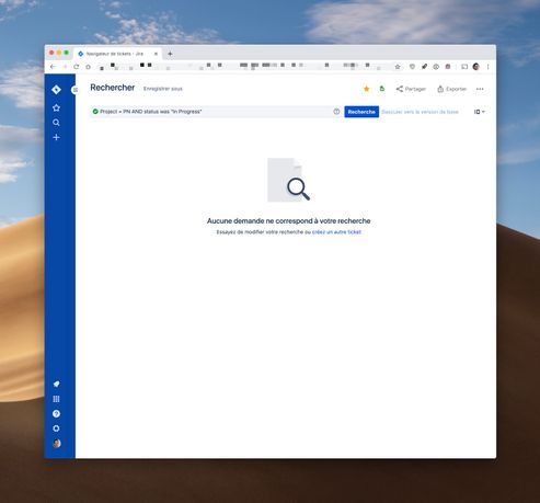

Actually, even the query
project = PN AND status was "In Progress"
without any date is not returning anything

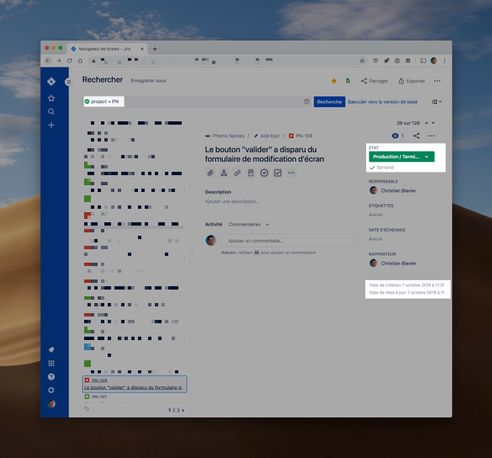

Wow - are you sure you have Browse Project permissions on that project? Can you take the status part off and see anything at all on the project?
Christian Blavier
November 14, 2019
I'm admin on the project, see screenshots below
John Funk
November 14, 2019
Thanks for sharing those. Can you go to the board and see if there are actually any cards for the In Progress status? Maybe even create a test card and move it to that Status to see if it will show up in the JQL.

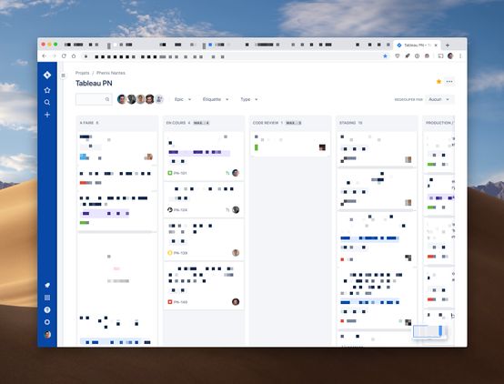

Here is my board with 4 tickets in the "En cours" status.
Is there as such thing as a workflow editor in Next-Gen projects?
