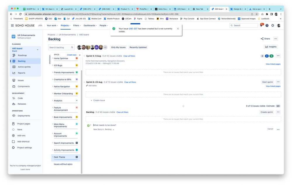

Usually, when in backlog view, I can select an Epic and then start adding stories to the backlog. When I add stories with an epic selected, these stories are auto-assigned to the selected epic. If I add stories without an epic selected, then the stories are not assigned to an epic.
In this new board, I select an Epic and add a story to the backlog, but am presented with a "Issue has been created but is not currently visible" dialog and the issue is not visible on the backlog view. I know this is because the issue hasn't been assigned to the selected epic, but I'm wondering why that's happening!!?

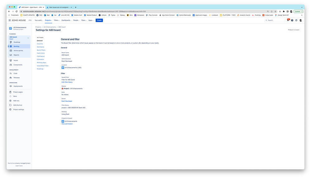

Here's the filter settings. I can't see anything worth changing that's going to resolve my issue.

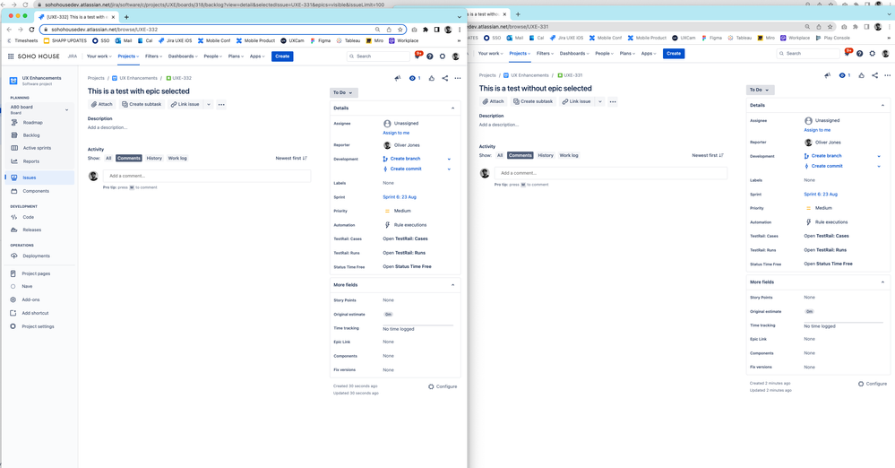

When I add a new issue without having selected an Epic, the issue does appear on the backlog view. It is visible. See comparison below, I don't see any difference in the fields:

I see now why you are getting the message.
Based on the images you provided, the issue you added while you have an Epic selected is not actually getting added as a child issue of the Epic. Notice that the Epic Link field is blank. Since you have the Epic selected in the Epics Pane and the issue you created is not actually linked to the Epic, the issue is not visible based on filtering by Epic.

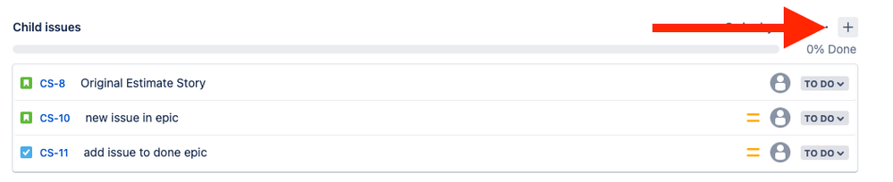

If you display the details for the Epic issue can you add a child issue to the Epic there?

To confirm, yes I can add a child issue to the Epic there. That works fine. The problem is just in the Backlog view.
