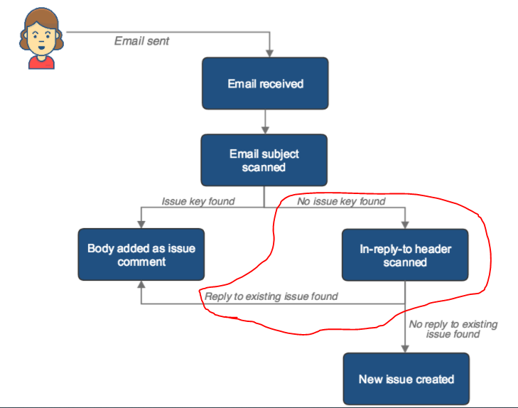

As per the attached diagram, if no issue key is found & reply to an existing issue is found- it should add as a comment. Please highlight how to fix this.

To create the comment its important to have issue key in the subject line otherwise how jira will come to know on which issue the comment will go.
If the user does not has the account in jira and does not get the notification in that case you need to send the email with issue key in the subject by using some automation rule or postfunciton script.

How are you expecting Jira to know which issue to comment on from an email that does not have any information on it about which issue to look at?
There's nothing that can be "fixed" here, you need to give the issue key to the users so they can use it in the subject of their emails.
