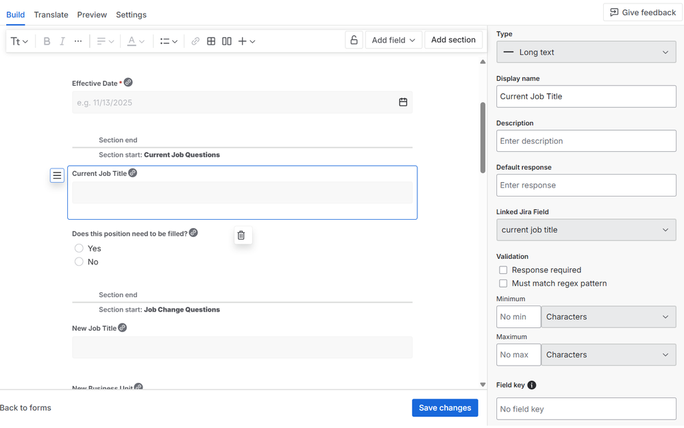

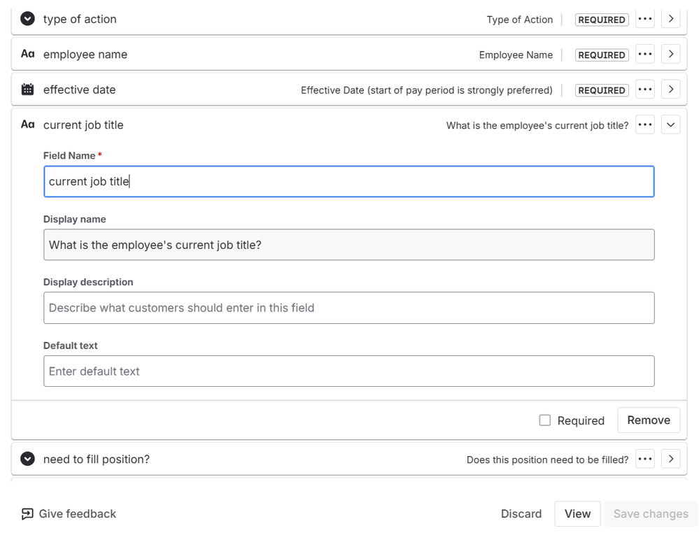

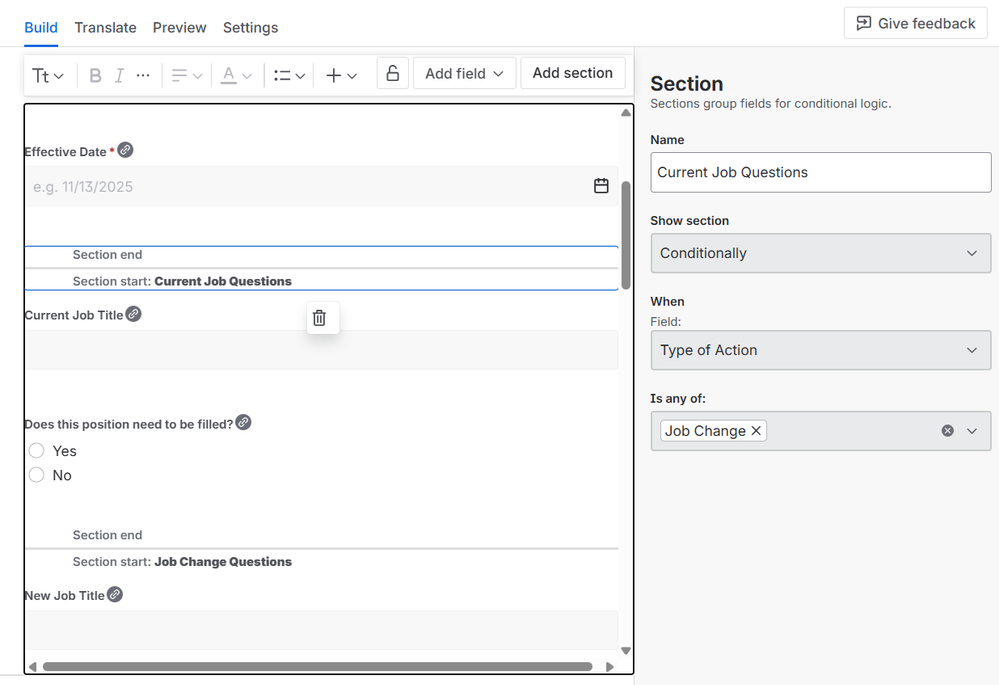

Clint Heinrich
November 13, 2025
Thanks for looking at this, Samuel. Hopefully you can see what you need here.
Samuel Gatica _ServiceRocket_
November 14, 2025
Could you please confirm whether customfield_11020 is actually designated as "current job title"?
Clint Heinrich
November 14, 2025
Hi Samuel,
I can confirm this. I created a test ticket using the request type, not the form. Viewing the created ticket at atlassian.net/rest/api/3/issue/PAF-168?expand=names I can see that customfield_11020 appears in two places - "customfield_11020":"current job title" and "customfield_11020":"test current title" (this was what I input to create the ticket).
