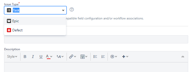

Hi, I attached an image - at a closer look it seems I can create an Epic, Task or a Defect issue when I click create Issue on the Kanban board.
It's not a super huge deal as I can work with Tasks and Subtasks - but I'm curious as to why this is the case.

Hi @JP
May be you haven't associated story issue type in the issue type scheme.
Or may be your organization is not using.
