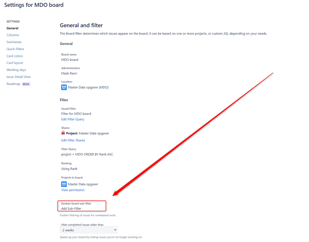

2 years later - I hope you found a solution @Omer Shoval Shakked , haha :-P
For anyone else who run across this issue, the problem I often have to fix is the sub-filter which is set to something. Remove that and all the issues appear on the board. It's in the board settings, just click the edit-pen on that line.
Hope it helps someone :)
