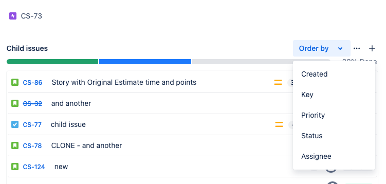

  1. The child issues of an epic used to sort by key, now they are sorting randomly.

Hello @Wp
1. The sort order is not random. You can elect how you want them sorted by clicking on the Order By option above the Child Issues list. If you don't select anything then they are sorted by Rank.

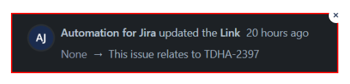

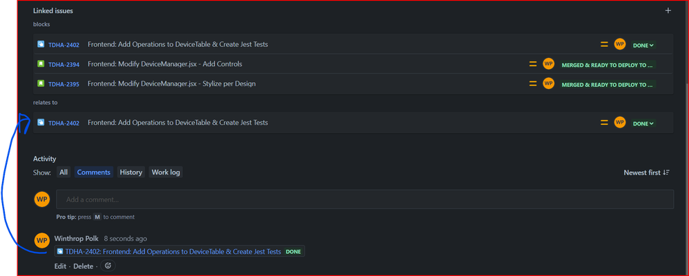

  2. Isolated issue: See screenshots. I can confirm that anytime a user enters a comment with a ticket number in it, it gets added as related even if already added as a blocker.
    • Can you please confirm this is NOT default operation?
    • Assuming the previous is true, can you please tell me where I should tell the Admin to go to look to fix locate and repair the custom automation? turnover is high and the Admin is not necessarily a jira SME.

2.1 I can confirm that what you are experiencing is not built in/default functionality of the Jira Software product.
2.2
The history screen image you provide is a clear indication that the link was added by Automation because it says the responsible party is Automation for Jira.
In either that issue or the other issue to which it is linked you should see a reference to the rule that was run.
