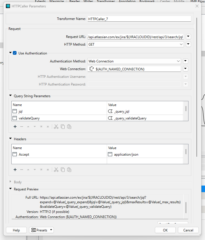

Before I start I am not an expert on this, we had a process set up by a former colleague which had always worked until recently. I believe it is due to the deprication of the old API. I updated the proces to point to:
https://api.atlassian.com/ex/jira/$(JIRACLOUDID)/rest/api/3/search/jql
instead of
https://api.atlassian.com/ex/jira/$(JIRACLOUDID)/rest/api/latest/search
I am using a HTTPCaller in FME for those familiar that looks like below, although the issue I am getting is also the case in Postman.
Every query now only returns a response body of
{"issues":[],"isLast":true}
This is regardless of what parameters I include or not. If I just have a project parameter such as:
https://api.atlassian.com/ex/jira/$(JIRACLOUDID)/rest/api/3/search/jql?jql=project=12200
it does the same, in fact it desn't matter what I put as the project ID (00000 would still do the same)
Full URL for ease of reading:
https://api.atlassian.com/ex/jira/$(JIRACLOUDID)/rest/api/3/search/jql?expand=@Value(_query_expand)&jql=@Value(_query_jql)&maxResults=@Value(_max_results)&validateQuery=@Value(_query_validateQuery)
example:
https://api.atlassian.com/ex/jira/$(JIRACLOUDID)/rest/api/3/search/jql?jql=project=12614 AND updated>=2025-10-14&expand=changelog&maxResults=1000&validateQuery=warn
All the parameters are the same as the old, succesful API version
Any assistance would be gratefully received

It turns out it was partially user error on my part as so ome my project codes were unusued so I thought nothing was returning, I have found some active project codes that do return results.
I still needed to use my https://api.atlassian.com/ex/jira/$(JIRACLOUDID)/rest/api rather than https://myAtlasSite.atlassian.net/rest/api to get data back.
However including Fields=*all as you suggested made the process a lot easier form that point, so thank you
