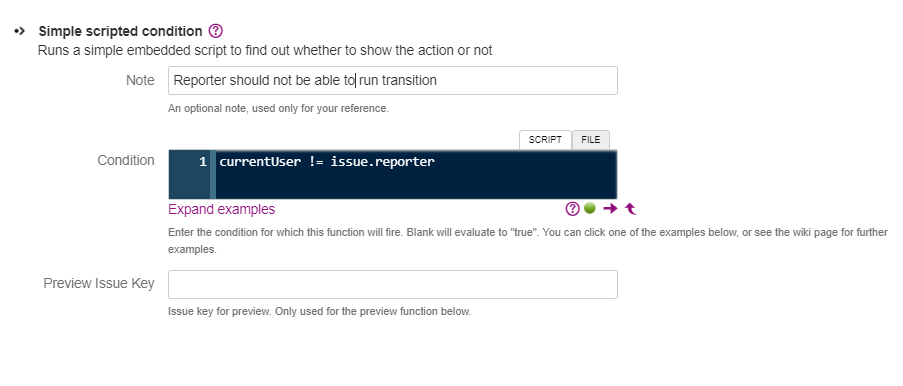

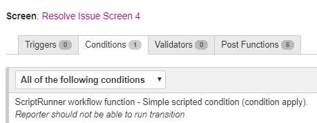

Hi,
This add-on does the job.
adaptavist ScriptRunner for JIRA
Just need to add the following condition to the transition:
