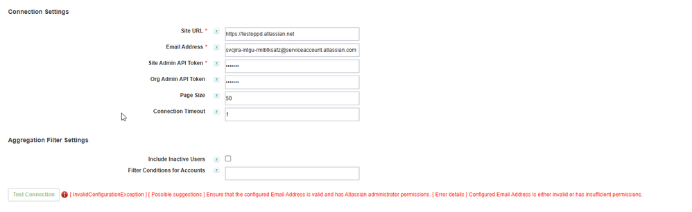

cjmorris August 22, 2025
Here are screenshots regarding the issue we are currently facing at the moment from Sailpoint.

Hi @cjmorris
The use you are using, is this use in the Atlassian administration and does this user have the correct access?
The message stated, is that one of this is not correct. The user needs to have site or org admin access
cjmorris August 25, 2025
Hi @Marc - Devoteam
The user in the screenshots provided is a Service Account setup within admin.atlassian.com
The account does have App Admin access as well as membership in the org-admins groups
Marc - Devoteam
August 26, 2025
Hi @cjmorris
I think the issue is with Sailpoint, it seems it doesn't recognise the service account email address, not as a valid email address.
What if you try the integration with an api token from another user in Atlassian?
