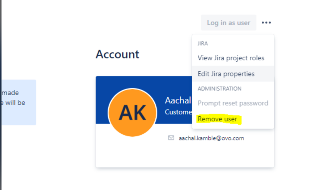

I am trying to build a bulk user deprovision script for our Jira platform using the REST API and python.
The current manual process is for the Tech Support team to select 'Remove User' when on the user's profile in the admin Administrator settings (see below screenshot).
