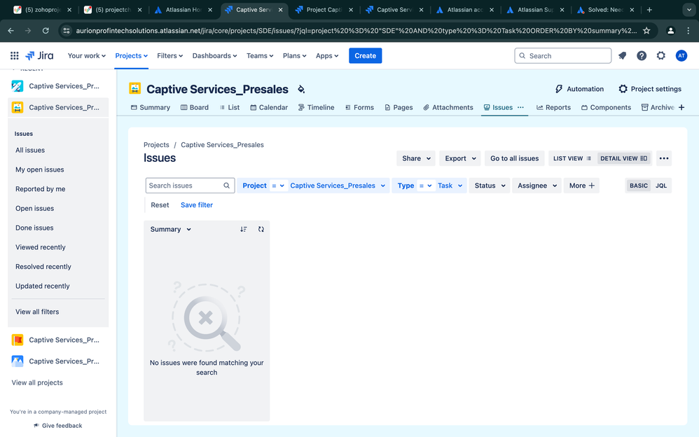

AGSuite Technologies
February 19, 2025
I do not find any option in this of issue id
Nikola Perisic
February 19, 2025
Ok, when you go to Project Settings, do you see Issues or Issue types?
February 19, 2025
No
February 19, 2025
Hi Please help me on this

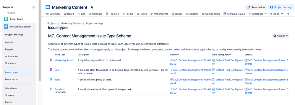

Nikola Perisic
February 20, 2025
@AGSuite Technologies
You have to click on the project settings (the cog icon):Screenshot 2025-02-20 at 09.31.07.png
This is from the example project.
