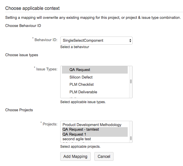

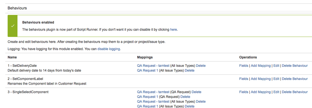

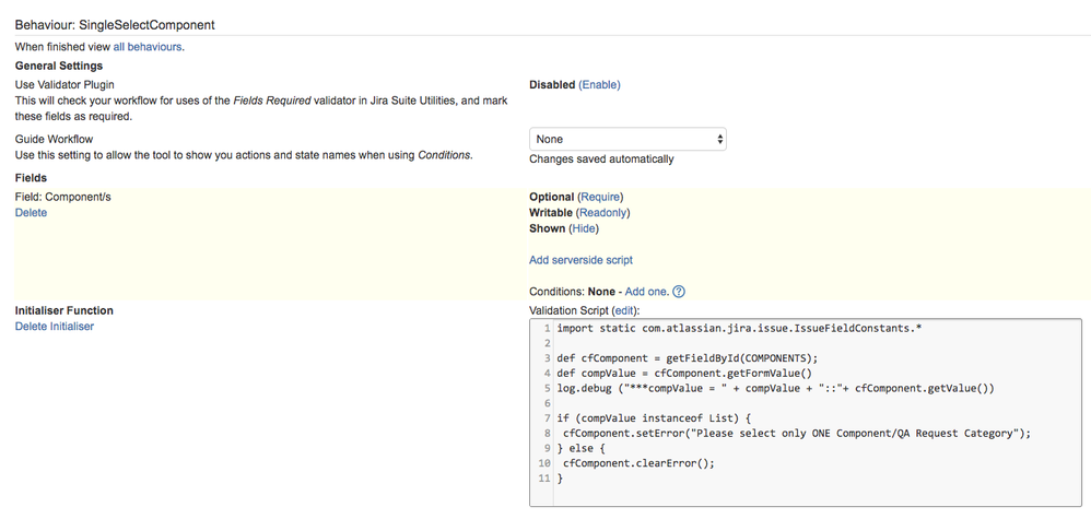

Yes I added a behaviour in ScriptRUnner. Please see my screen shots...
2017-11-30 11:22:45,487 http-nio-8080-exec-25 DEBUG W0017963 682x67004x1 1aj7tyb 172.21.132.162 /rest/com.onresolve.jira.plugin.Behaviours/1.0/behaviours/validators.json [c.o.j.groovy.user.FieldBehaviours] ***compValue = null::null
You added script to the wrong place.
Look, there is a link Add serverside script above Conditions None. You have to add there
