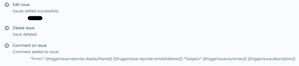

Blerim
January 23, 2023
Hi @Ste Wright thank you for your help and time, i did set this rule up and it seems it is working. attachments and comments are written to the trigger issue, and the original new issue is also deleted now. I tested this with a simple mail and with a mail with 5mb attachments.  👍
would you kindly explain why the information from the trigger rule are able to write to the branch rule even when delete issue action is executed before? Is jira here doing something like undocumented caching when doing *lookup issues* and *re-fetch issue data* before executing the branch?
because in the test with the 5mb attachment i see in the logs that it deleted the issue before writing the comment. the comment is copying data from the triggerissue and still it worked despite the issue has been deleted?
Ste Wright
February 4, 2023
Hi @Blerim
I couldn't give you a technical answer on this - I don't work for Atlassian, I'm just another user like yourself!
It might be that the actions are happening in parallel? Or the Lookup action takes a note of the details?
Either way it seems to work :)
Ste
