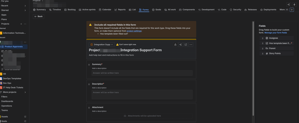

thank you for sharing, this is helpful, but but the problem is that the forms feature in jira core doesn't support adding fields like it does in JSM. I don't see a way to add a custom field into this form form unless it exists as an actual custom field in jira.
Maybe I am missing something as this is my first time using forms in JIRA

Ah, missed that it was Jira and not JSM. Unfortunately in Jira this is not possible unless you use an app from the Marketplace. The form in Jira only works on issue create.
