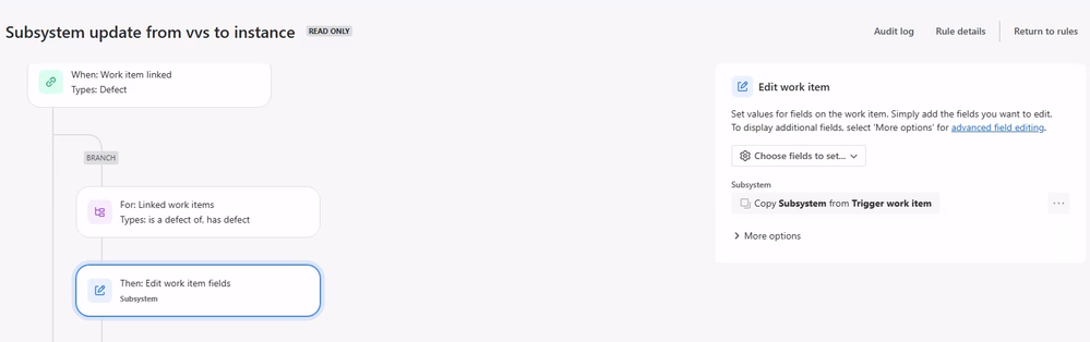

Thanks for the reply. Please find the below details.
It's a company managed projects.

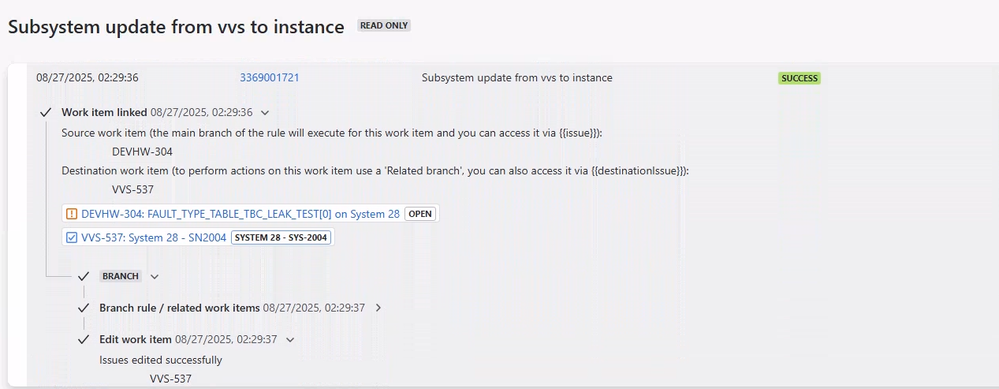

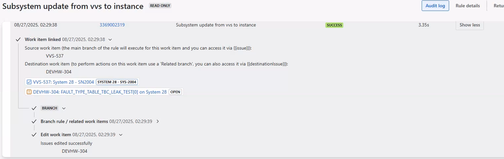

With a above rule, I'm getting two kinds of output. In first audit log its editing the DEVHW ticket which is correct. But in the second audit log its editing the VVS ticket which is not correct.

When user mistakenly reverse the linking type then custom field value from Instance is updating in Task, which should not happen.
