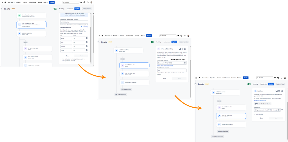

However, you might want to follow this suggestion - AUTO-32. If by implementing this suggestion it would be possible branch on values sequentially (and not in parallel as it is at the moment), you could probably construct something like this:automation-example.png
Basically, with Lookup table you would map each option in the multi-select field with 'weight' for each option.
Next, you could iterate through each value in the multi-select field and get each value weight from the table you defined previously. Lastly, you would use a math expression in the number field to sum up all weights into that one field.
E.g., in the number field you can have an expression like this:
{{triggerIssue.customfield_10486}} + {{weightMapping.get(item).asNumber}}
Again, note that I didn't manage to get it to work, as branches just run concurrently and they execute too fast (even w. re-fetch or delay actions).
If Atlassian releases sequential iteration in the branches, I think this would be a 'cleaner way to go' compared to IF/ELSE blocks.
