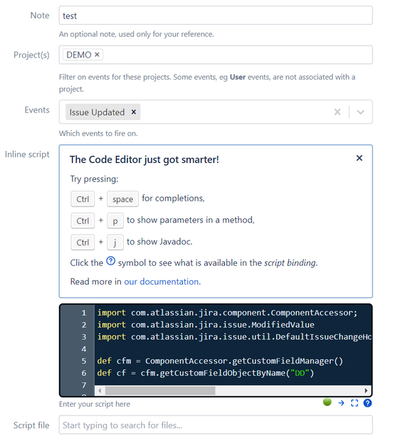

Hi
import com.atlassian.jira.component.ComponentAccessor;
import com.atlassian.jira.issue.ModifiedValue
import com.atlassian.jira.issue.util.DefaultIssueChangeHolder
def cfm = ComponentAccessor.getCustomFieldManager()
def cf = cfm.getCustomFieldObjectByName("DD")
if ((event.issue.getDueDate() != event.issue.getCustomFieldValue(cf)) && event.getChangeLog().getRelated('ChildChangeItem').find{ it.field == 'duedate'}){
def changeHolder = new DefaultIssueChangeHolder()
cf.updateValue(null, event.issue, new ModifiedValue(event.issue.getCustomFieldValue(cf), event.issue.getDueDate()),changeHolder)
//log.error(event.issue.getCustomFieldValue(cf))

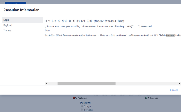

log.error(event.getChangeLog().getRelated('ChildChangeItem'))

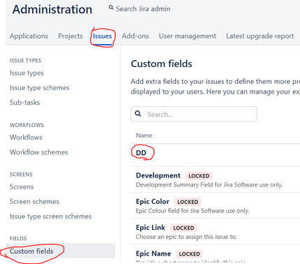

I tested in my local instance work well. For system 'Due date' name in
def cfBLDD = cfm.getCustomFieldObjectByName("Your field name(Custom fields)")
and in
if (event.getChangeLog().getRelated('ChildChangeItem').find{ it.field == 'Your field name(check log)'}){
are different. For "Your field name(Custom fields)" see in 'custom fields' web admin panels and for 'Your field name(check log)' use log.error msg in listener web panel. I suppose your field also have different name.
B.R.

'Baseline Due Date(check log)'
- it is wrong.
You need find it here
You need find that name in output from logs. If You want You can call my in skype (AndrewDvizhok@gmail.com) or write in my linked (see my profile) I show in my instance.
B.R.
Hi @Andrew , I get the below log,
2019-10-28 12:39:38,195 ERROR [runner.AbstractScriptListener]: ************************************************************************************* 2019-10-28 12:39:38,195 ERROR [runner.AbstractScriptListener]: Script function failed on event: com.atlassian.jira.event.issue.IssueEvent, file: <inline script> org.codehaus.groovy.control.MultipleCompilationErrorsException: startup failed: Script713.groovy: 12: unexpected token: @ line 12, column 49. issue.getCustomFieldValue(cf)) ^ 1 error

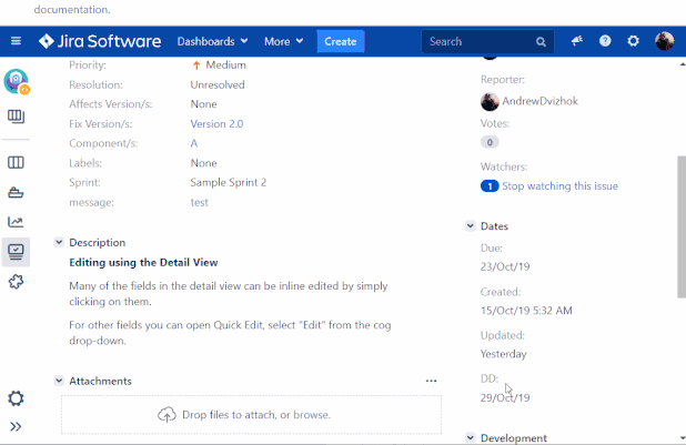

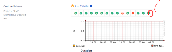

The script looks like it ran .
LOG
2019-10-30 19:28:28,257 ERROR [runner.AbstractScriptRunner]: [[GenericEntity:ChangeItem][newvalue,null][field,Fix Version][oldstring,Test Release-11202019][newstring,null][id,12973873][fieldtype,jira][oldvalue,54400][group,10027046]]
But I cannot find my "Epic Baseline Edited Date" on the issue card. It does not even show up :(

@Andrew Hi. Actually due to compliance issues, I am unable to share my screen or send you a screenshot :(
Epic Baseline Edited date is a view only field. I mean the users should not be able to edit it, as it only captures the dates on which the Baseline Due Date was modified. So, I have added this field only to the VIEW screens.
At the listener page, the script is showing as run successfully, but I couldn't find the Epic Baseline Edited Date on the issue card.

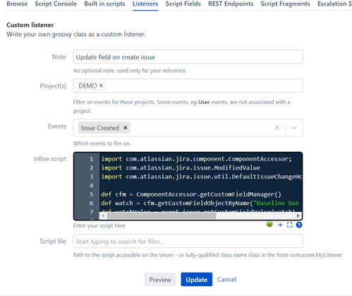

Hi,
Sorry for long answer, I had a vacation.
I suppose You need make new listener with event 'Issue created'.
Something like next:

Hi,
You need create second listener.
Script:
def watch = cfm.getCustomFieldObjectByName("Baseline Due Date")
def watchValue = event.issue.getCustomFieldValue(watch)
def updatedWatch = cfm.getCustomFieldObjectByName("Epic Baseline Edited Date")
def today = new java.sql.Timestamp(new Date().getTime())
if( event.issue.getCustomFieldValue(watch) == null ){
updatedWatch.updateValue(null, event.issue, new ModifiedValue(null, null), changeHolder)
}else{
updatedWatch.updateValue(null, event.issue, new ModifiedValue(null, today), changeHolder)
In sum You need two listeners. The first works on the update event (from video), the second works on the creation event (current comment).

Hi @Andrew , Hope you are doing well ! :) You had helped me long ago with this above script. I'm facing a small issue, and don't know how to fix. Can you please help.
The script is running with no error, but the field is not getting displayed on the issue card page. Can you please me with what could be the reason for this ? Thank you
