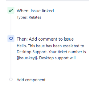

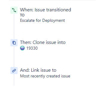

I am trying to make a rule that will comment on an issue when it is linked. We already have a rule that links issues, and is working fine, and I'd need my rule to execute when that automation happens. The "allow rule trigger" box is checked.
Above is the rule that clones and links the issues (this part is working and has been for a long time) and the link issue is set to "relates to most recently created issue."
Above is the rule that I would expect to leave a comment in response to previous rule executing, but as I said, it's never executing (as in, the rule doesn't fail, it just doesn't run at all)

I have tested out the scenario and it is working for me.
As suggested by @Bill Sheboy, the link types should match in order for the second automation rule to trigger immediately.

Rule 1:
  • When issue transitioned from one status to another
  • Clone issue (same project and same issue type)
  • Link issue to (most recently created issue and selected 'is cloned by')
Rule 2:
  • When issue linked (selected 'Link types' as 'Cloners')
  • Add comment to issue
  • Checked the 'Allow rule trigger'
Hope this helps.

Have you confirmed the link type in your trigger matches what is happening in the issue?
If you are unable to modify the source rule (which is a good idea for this use case), why not clone it, disable the source rule, and add the comment?
Have you confirmed the rule's scoping?  For example, is the first rule a multi-project rule, and perhaps it does not include the project where your second rule is defined.
