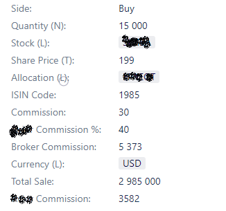

Hi Guys,
I am new to script runner and I am not a developer . I need some help to return a calculation , but it seems like something goes wrong somewhere.
When a number like 199 is input in the text field everything works and my custom fields returns values . As soon as I use a number like 199.50 the fields don't return anymore .

The following fields are text fields (the reason it is text is so that nrs are not rounded off) :
Share Price T
Broker Commission
And Last Commission is also a text field.

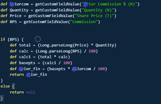

Ok, so you have numbers in text fields, the trick there is that you'll need to read them out as numbers (you can't just wedge strings into number fields, they need to be interpreted)
From memory, the easiest thing to do is use the parse functions in Java - assuming BPS is a string that contains a written number, try
def calc = ( Long.parseLong(BPS) / 100)
Chris Scheepers
March 8, 2022
Hi Nic,
Still no luck :-(
I entered the Long.parseLong before all the text fields . It works when there are no , or . in the numeric values in the text field. as soon as the price field has a . in it , it fails with this error :
Script field failed on issue: OV-42, field: *ior Commission (SF) java.lang.NumberFormatException: For input string: "200.50"
My edited script looks like this now as you advised :
Nic Brough -Adaptavist-
March 8, 2022
I am really sorry, I've told you some total junk there!
Well, the idea is right, but I've picked the wrong method.  Longs are integers, they can't handle decimals.
So, I'm sorry to have to make you re-do a load of edits, but try:
def calc = ( Double.parseDouble(BPS) / 100)
