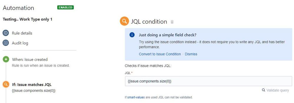

Hi Bill. Thank you for getting back to me. I was using it in the Issues/Search Issues but not on automation. I have created new automation. Is this where it is supposed to go?
Diana Leon
December 2, 2021
I tried it and it did not work.
No subsequent actions were performed since JQL condition did not pass due to error running JQL:
"(key IN (TICKET NUMBER) AND (2))" - Error in the JQL Query: Expecting operator but got ')'. The valid operators are '=', '!=', '<', '>', '<=', '>=', '~', '!~', 'IN', 'NOT IN', 'IS' and 'IS NOT'. (line 1, character 33)

Thanks for your rule image and additional information.  I should have been more clear that I was suggesting to use a condition in the rule.  For example:
  • trigger: issue created
  • action: Re-fetch (to prevent the known timing problem which could occur)
  • advanced compare condition:
    • first value: {{issue.components.size|0}}
    • condition: does not equal
    • second value: 2
  • action: comment/email/... to notify that the components do not match what was expected
Nic's answer with the dashboard gives you the overall status view of issues meeting/not meeting your component criteria.  I was also suggesting the rule approach as you already noted using an automation rule.
