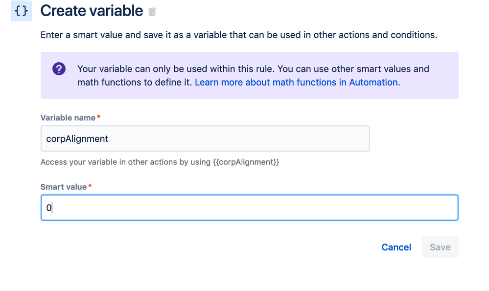

  2. Set up 6 actions of the Create variable type and define them all as 0. Doing this will allow you to default them to 0 and update them later in your rule if the field is populated.

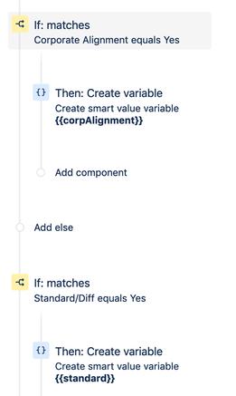

  3. After creating a variable for each field, you'll need to create 6 If/Else conditions: Make sure they are if/else blocks so that if the fields are not populated the rule will finish running

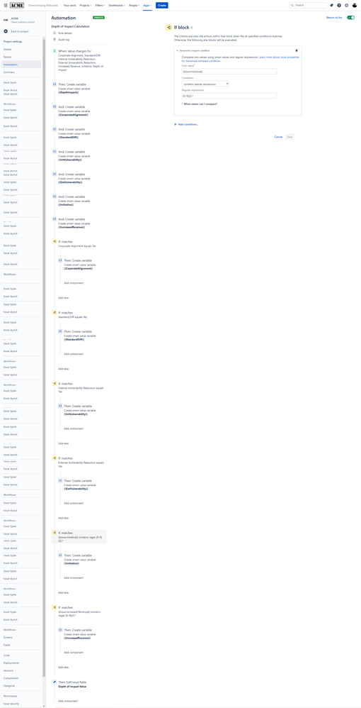

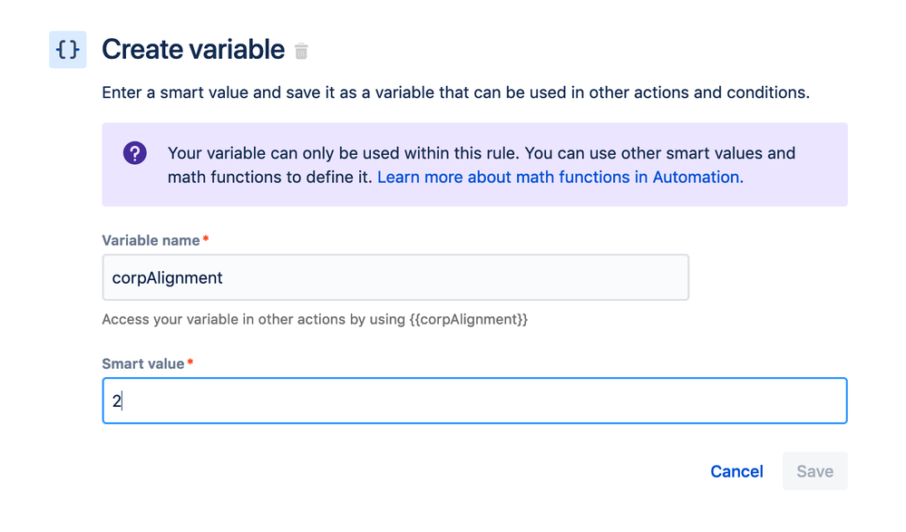

  4. Each of these If/else blocks will check to see if the value exists. If it does, update the value of the variable as follows:

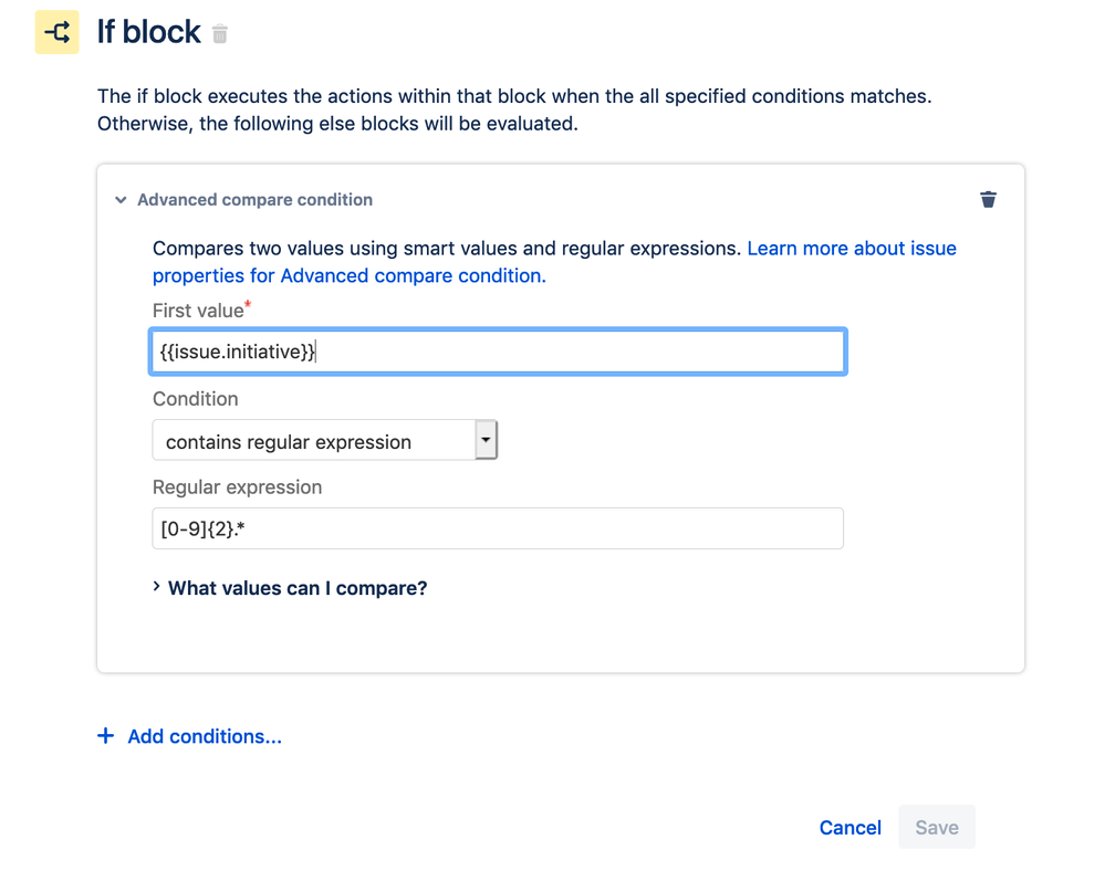

  5. The only one that will be different is the Initiative field you mentioned earlier. To check that one, you want to do an Advanced check and check to see if it begins with two numbers. You can do that like this:
  6. Then, to set the value for the initiative variable you should have defined earlier set up the action as follows:

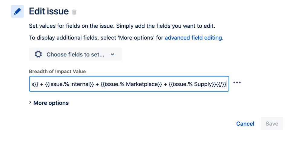

Put the smart value in the Breadth of Impact instead.

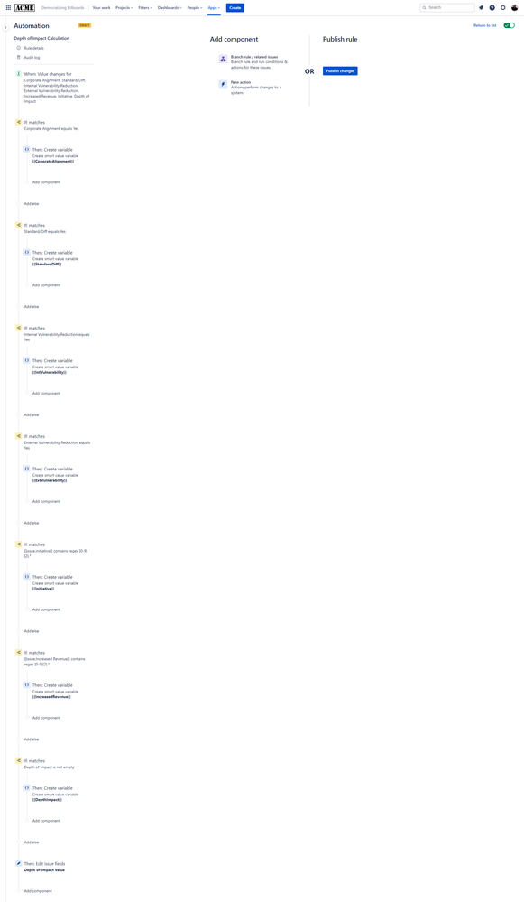

Mark Ewart
February 25, 2021
Getting the following error:

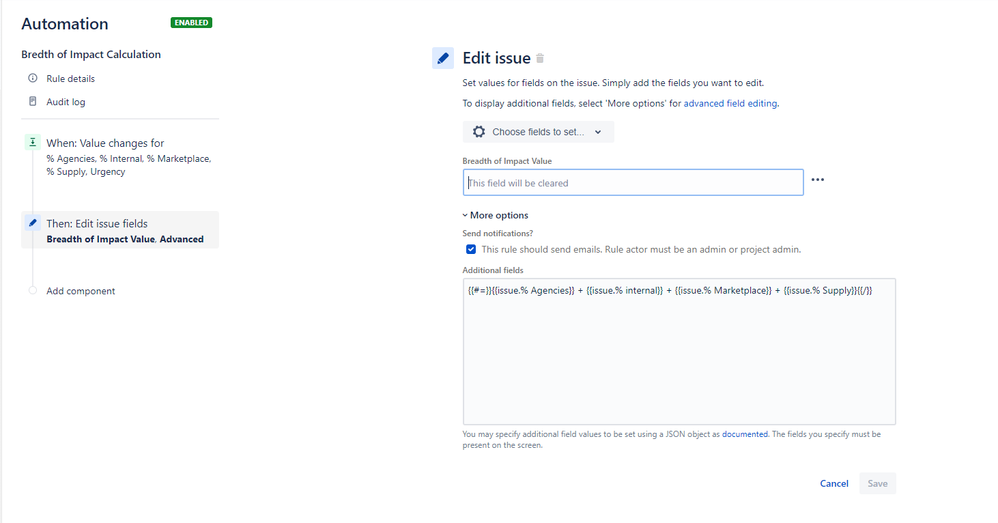

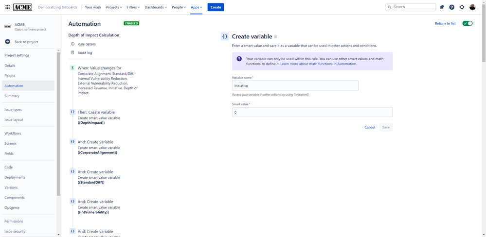

Here is how I have the rule layed out in case I have it wrong:
Kian Stack Mumo Systems
February 25, 2021
@Mark Ewart
You missed the very first step. You first need to define the variables so that they'll be available when you perform your calculation at the very bottom. So first define all the variables you want to use, and then use the If/Else blocks to set the values if they are populated.

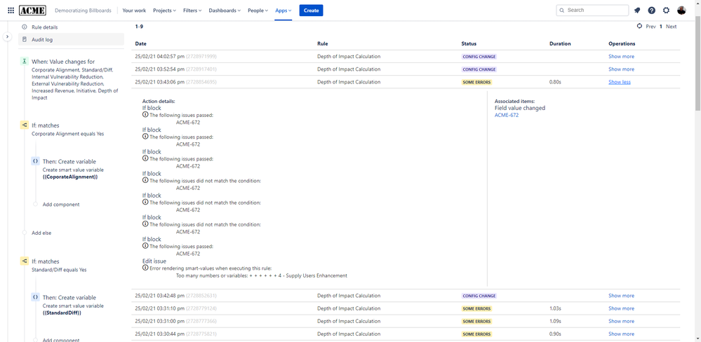

Mark Ewart
February 26, 2021
Are you sick of me yet!?
It does make sense.  Thank you!  Sorry for being such a newb!  :)
I fixed that error and now I am getting:
Edit issue
Error rendering smart-values when executing this rule:Unknown operator or function: ADKOM: 1 - ADKOM/Agencies + 0 + 1.5 + 2 + 0 + 0 + 0

Can you show how you defined the variables for that? It appears that its pulling the whole value. Given that it doesn't appear to have any numbers at the front,  it should not be setting that as the value.
What is your initial value set to for the Initiative variable?  It should be set to 0.

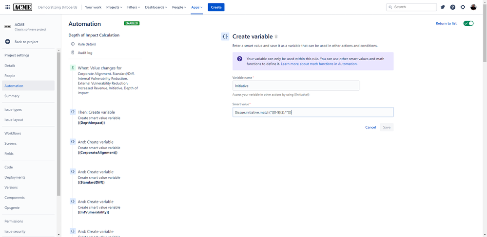

Mark Ewart
February 26, 2021
This is the Variable in the If Block:
The initial value is set to 0

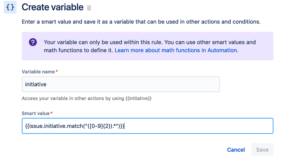

February 26, 2021
Your smart value setting is wrong.
Try this:
{{issue.initiative.match("([0-9]{2}).*")}}
