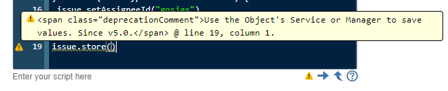

Tennille Noach
February 6, 2019
Hmmmm the last line is showing an error  issue.store()   ?
Tennille Noach
February 6, 2019
I removed the last line from the script just to see if it would work, and it seemed to look ok in the field where the code is written i.e. the green light indicated that there were no errors in the script, but when I update the workflow and then try to test it, none of the sub-tasks are updated with the individual users specified to be Assignees in the script - it just keeps adding the Project Lead as the default Assignee?
