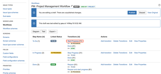

what is transition and transition id.how can i identify this transition id.Could you please help me on this.

When you create a workflow, you add statuses and then connect statuses by transitions. When you go from the To Do status to the In Progress status, you push a button. This button performs a transition. You can find the transition id, if you open your workflow in edit mode. In the picture the id of the In Progress transition is 11
