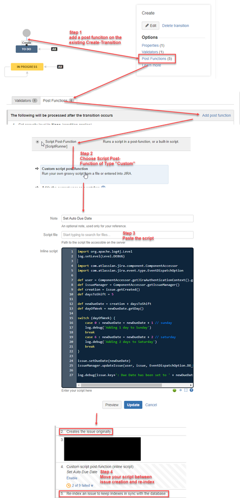

Do it with a Scriptrunner Postfunction.

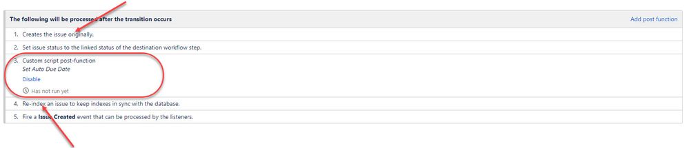

  1. Create a scriptrunner postfunction on your create transition, type: custom
  2. Move the Postfunction between the creation step and the re-index step
  3. Add this code

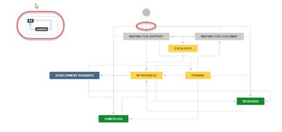

@Leonard Chew - Thank you for all the information, I just a beginner - Could you please send some screen shots on steps I need to follow to get this Implemented.
I tried below option but didn't know how to proceed to next step.
I created a transition in workflow as custom

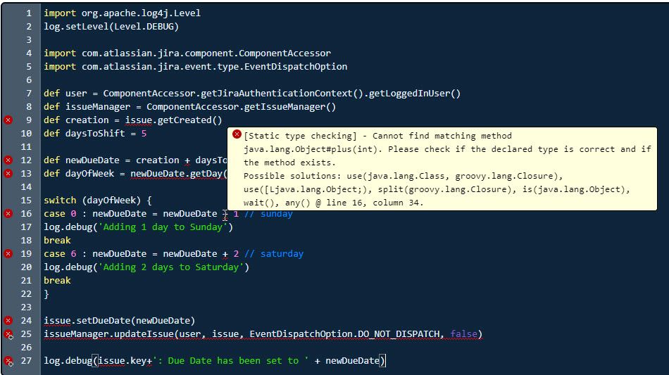

Jira_Custome.jpgI also got below error messages in console

Hmm, if you lack knowledge of jira-administration basics, it might be wise to persuade your manager to give you an administration course, before you work with scripts.
That said, here are the answer to your questions:
1) General: The script will not work if you paste it in to the script console, as the console does not know on which issue it should run on.
In a postfunction-script, the issue is automatically set to the issue currently being transitionend (created in our case).
2) Do NOT create a new transition. This postfunction should run on the initial "Create"-Transition, which is the line from the circle to the first status. The script automatically sets the due date when an issue is created through this workflow.
Here are some screenshots pasted together to get it to work:
