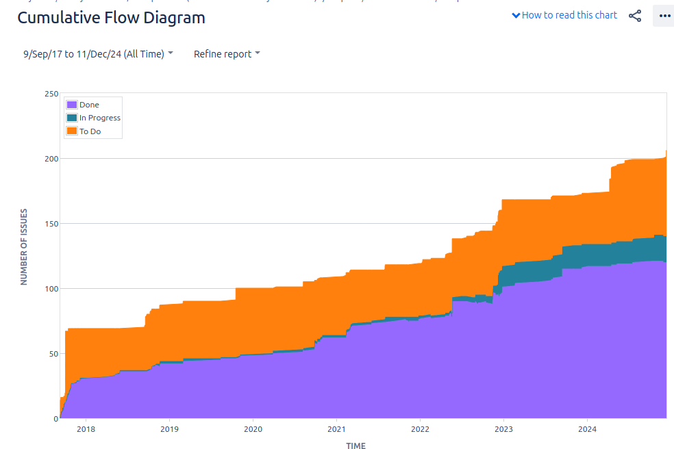

Looking at your requirement, an option would be to try using the Cumulative Flow Diagram report of Jira.
If this report is not good enough for you (unfortunately it is not so configurable), then I recommend searching for an app on Atlassian Marketplace that provides such report or gadget.

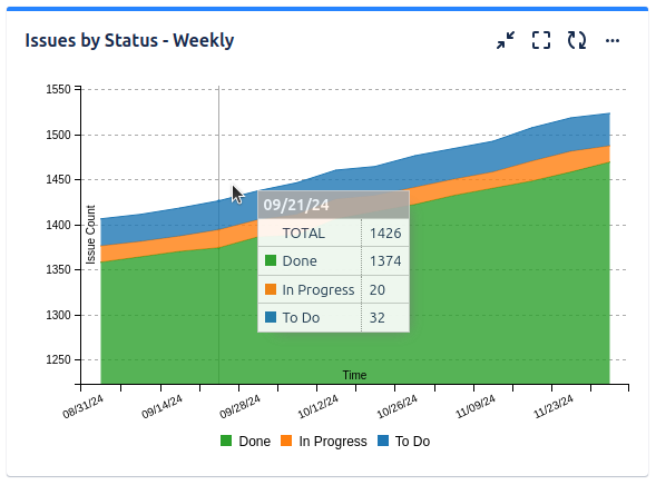

If you consider the idea of using a plugin, our Great Gadgets app offers a powerful Cumulative Flow Diagram Chart gadget that can display this info for you with just a few clicks.
