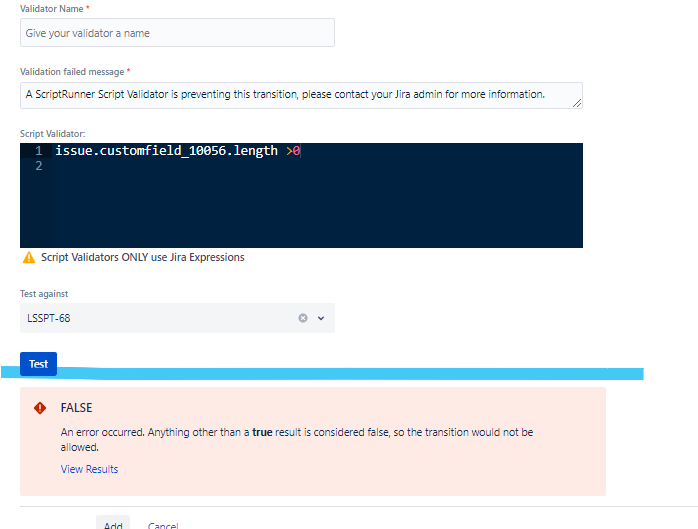

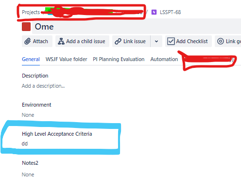

raju mandapaka
January 18, 2024
Hi @Kristian Walker _Adaptavist_
I already tried this, but it is not working. here are some of the screen shots.
In above case, it should be true.
Please advice.
Thanks,
Raju
January 18, 2024
Hi Raju,
I have tested this expression in my instance with a multi-line text custom field, and it works as expected.
Can you please save the actual validator and run this as I believe it will run as expected when the workflow transition is run as the issue you are seeing is just the test not recognising the field type correctly.
Regards,
Kristian
