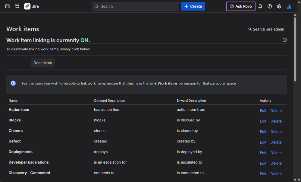

melissa_erhard November 10, 2025
Hi Tobi,
Thanks again for taking the time to help me with this.

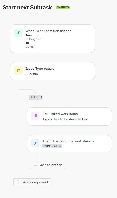

I’ve attached a screenshot of one of my current automation rules.
In this case, I used the "has to be done before" link type to connect my sub-tasks.
My goal is that when one sub-task transitions from "In Progress" to "Done", the next sub-task (based on that link) should automatically move to "In Progress".
However, right now the rule works in the opposite direction:
If I move a sub-task from "Done" back to "In Progress", then the next sub-task starts — so it seems like the link relationship is being interpreted backwards, even though I set it as "has to be done before".
Another issue is that the rule only works on the second attempt, never on the first one.
For example, the first time I move a sub-task to Done, nothing happens.
Then, if I manually repeat the same action (moving to Done again), the next sub-task suddenly transitions correctly.
That’s why I also tried splitting the logic into two separate rules:
(1) One rule to trigger the next item (for example, by setting a flag or field).
(2) Another rule that reacts to that trigger and transitions the next sub-task to In Progress.
I thought that might make the update sequence more reliable, but it didn’t solve the issue either.
So right now, these are the two main problems:
The direction of the link seems reversed (Done to In Progress instead of In Progress to Done).
The automation only works on the second or third attempt, never on the first.
To keep things simple, I started testing with this basic version (without JQL or Sequence fields) before moving back to the more complex setups. I only want one next item to be triggered, not multiple.
If you have any idea where the direction or timing might be going wrong, I’d really appreciate your thoughts.
Thanks again for your help and patience!
— Melissa
Bildschirmfoto_10-11-2025_111218_ommax.atlassian.net.jpegBildschirmfoto_10-11-2025_111923_ommax.atlassian.net.jpeg
