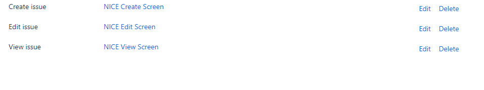

Hi,
I am one of the administrators of our org JIRA instances.
In setting up our screen, I have noticed a behavior that is confusing to me and I can't find documentation for.

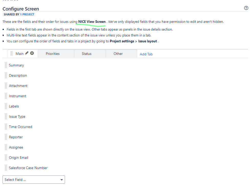

Behavior I see
This has to do with the Edit and View Screen and also the Issue Layout.
My understanding of the Screen Scheme is as follows.
Since editing and viewing of issue happens on the same page now, the Edit Issue Screen has the fields that are editable and the View issue Screen has fields that are visible.
So if Edit Issue has fields: A,B and View Issue has A,B,C
You will see field C, but you won't be able to edit it.
I have also noticed you can affect the View Screen through the Issue Layout Screen.
If you drag any of the fields on the right, It shows up in the Edit and View Screen.
I bring this up because now if something is not in the Edit Screen, but in View Screen, it still doesn't show up.

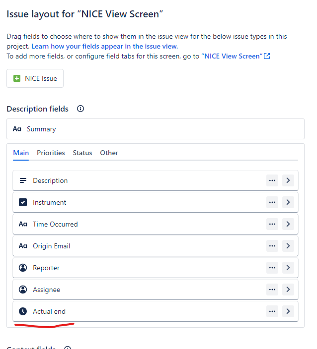

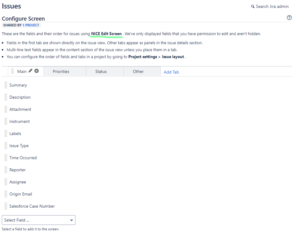

Example
Lets take the field "Actual End" as an example
Its not in Edit Screen
Its not in View Screen

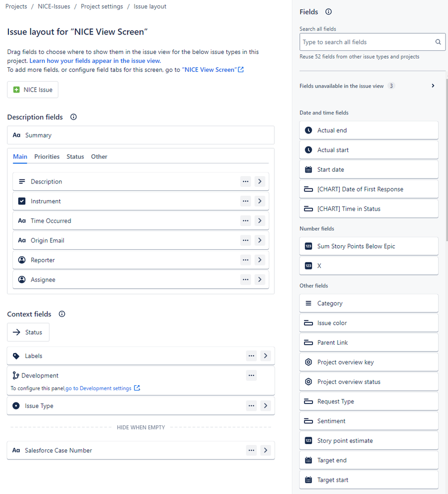

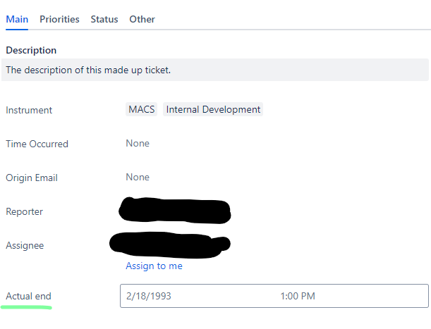

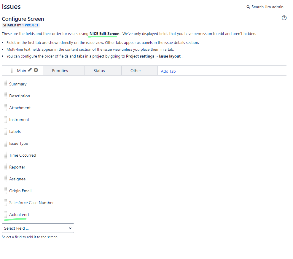

Now lets say I drag "Actual End" field to to main tab
It appears
Its also editable.

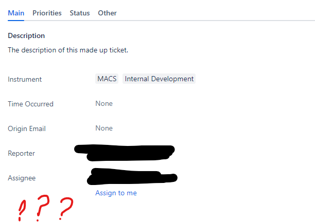

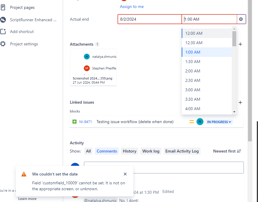

Now lets say I don't want it to be editable.
I disappear from the ticket

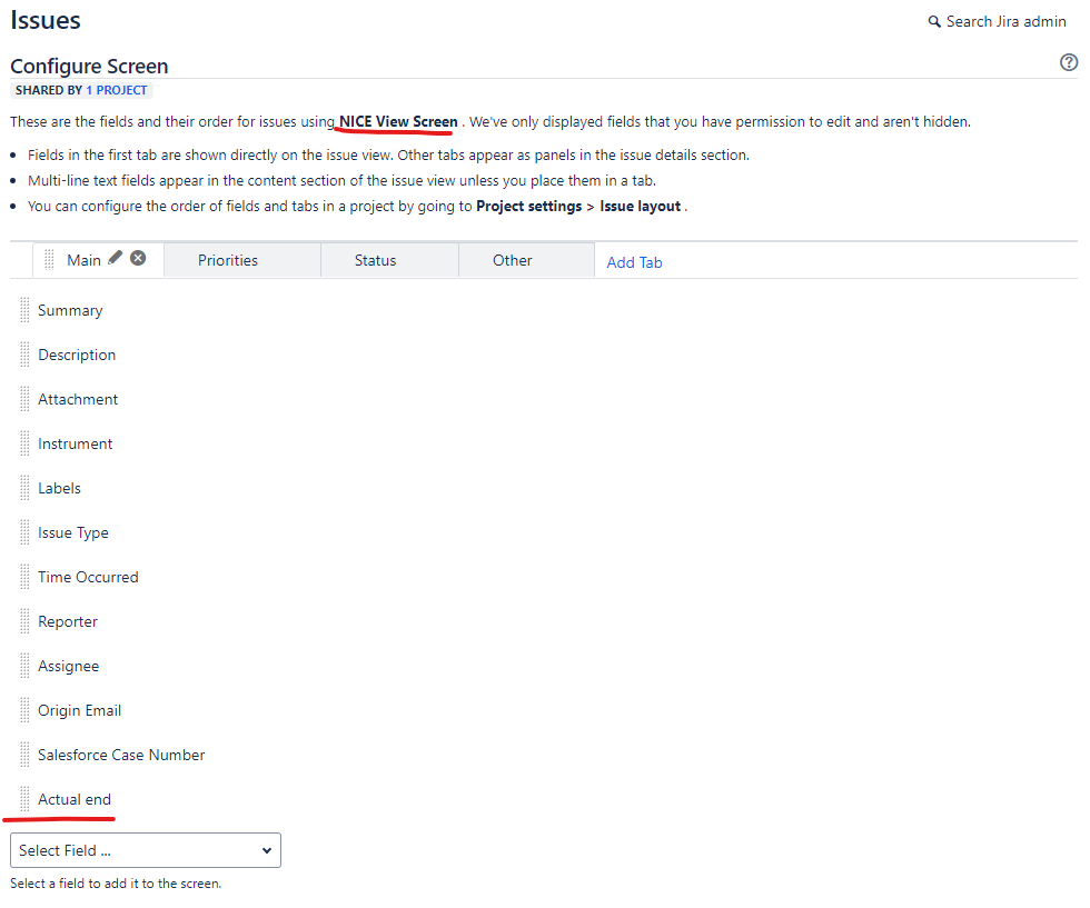

Even weirder, its still in the Issue Layout and View Screen.
This behavior is weird to me.
Can someone explain what is happening to me?

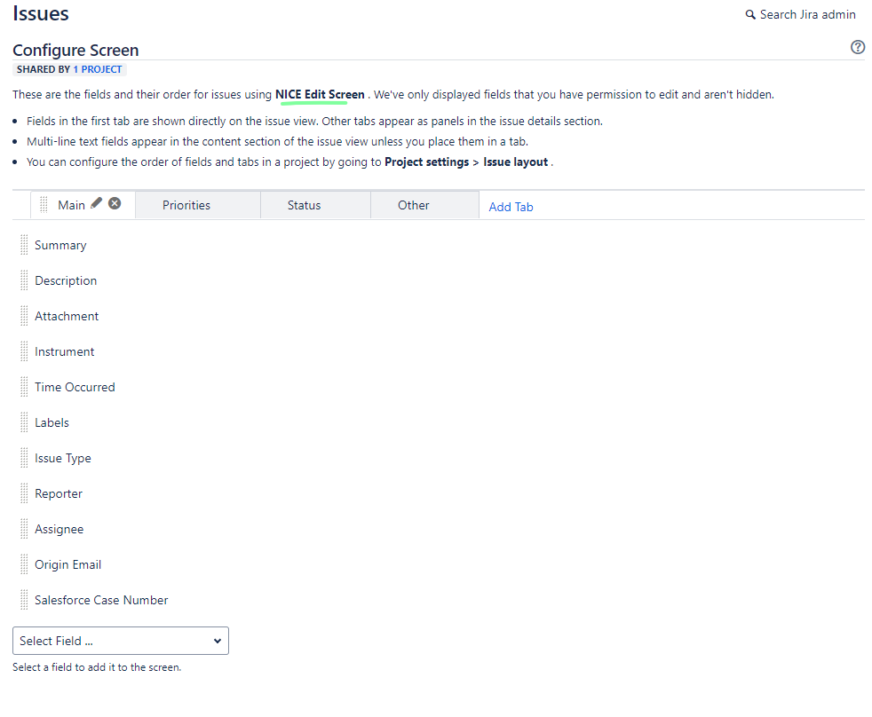

What happens if you fill the field with a value on an issue before removing the field from the edit screen?  I suspect that you then will see the field on the screen of that issue (but not be able to edit the value)
It seems you are not able to edit if you remove it from the edit screen
If you remove it from both edit and view screen, it gets removed.
I did another experiment and it seems removal from the view screen is what removes it from the issue layout.
You have to manually remove it from the edit field though.
It doesn't seem there is a way to have a non editable field...

Interesting indeed. If you keep the field on your view screen, and not on your edit screen but have a transition screen with the field on it to fill it on a specific time in the lifecycle, it won't be visible ?
I see there is some sort of explanation on the interconnection between layout and screens in this documentation:
"The new issue view uses the View issue screen scheme to determine which fields to show. To add or remove a custom field, head to your project, Choose Settings > Screens, then select the View issue screen scheme and remove the field."
Must be a typo in the documentation though. It should be sufficient to write "View issue screen", not "View issue screen scheme". Afaik there is no such thing as a view issue screen scheme.

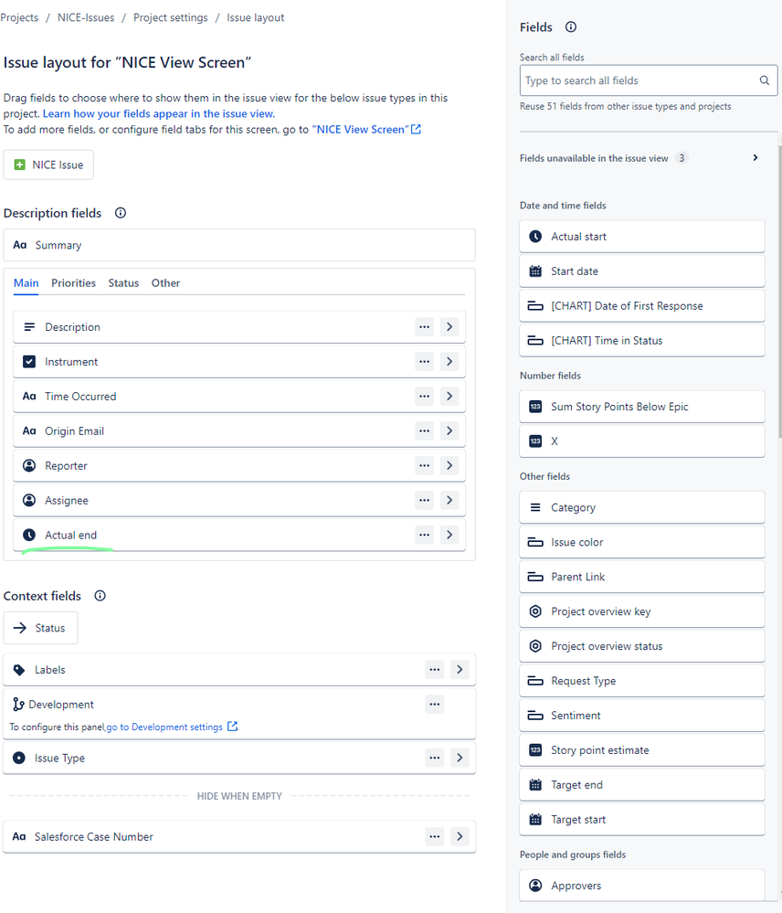

Fawaz Joseph
August 2, 2024
If I refresh the page, the fields would not be visible.
However If I didn't refresh the page, while it was in both View and Edit Screen, remove it from the Edit Screen, try to edit the field; I get the error.
If I refresh afterwards, It will be gone.
Thanks for the documentation, Lisa.
However, I don't know what the Edit issue screen is for anymore then.
It seems to influence visibility now.
