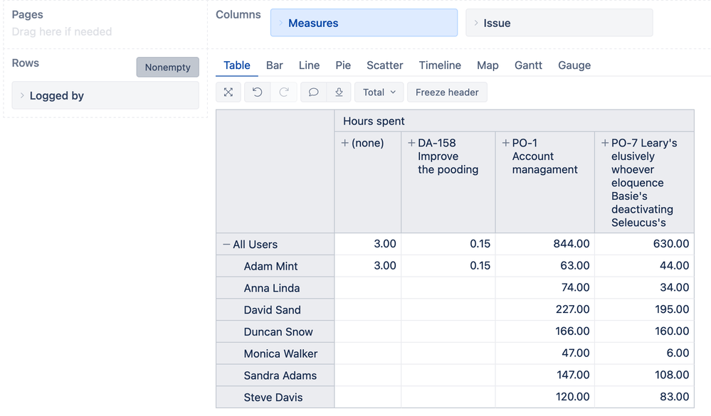

Further, you can use the Hours spent measure together with the Initiative level in the Issue dimension selected on Columns and Logged by dimension on rows:

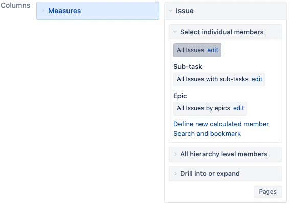

@Lauma Cīrule I do not see the initiative level to add?
I do not see Initiative?   Here is what my settings look like:

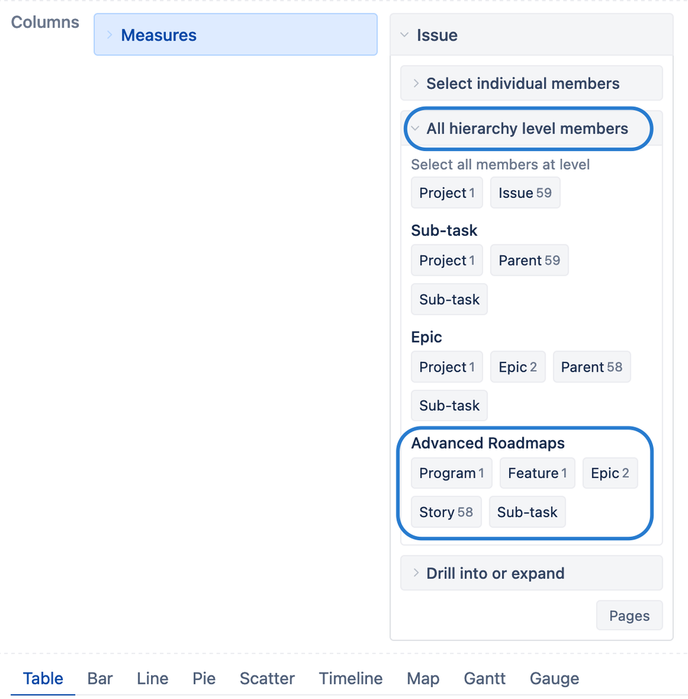

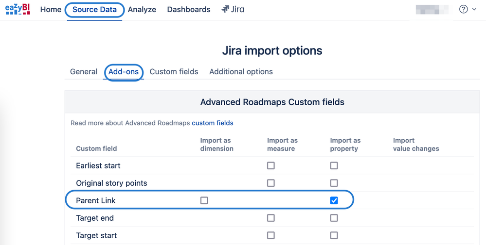

@Robert Nadon, While the configuration in the advanced settings seems correct, I imagine you have not selected the Parent Link custom field for import from Source Data / Jira / Add-on tab.
After importing the Parent Link, you should see the Advanced Roadmaps hierarchy in the Issues dimension and would be able to select the desired level from All Hierarchy level members (I don't have the Initiative level, but just an example with a hierarchy):
If you still experience problems, please write to support@eazybi.com with your site and account details so we can go on to find what's still missing.
