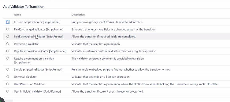

Thanks @Steve Long -Evelon-  for your responce.
i not familiar with coding for script runner, Please find the screenshot attached and help me which one we need to select to make the Epic Link field mandatory while creating issue and based on your response and also provide me with code if needed.validator.JPG

Steve Long -Evelon-
May 15, 2023
@Ram Raj the easiest way for yourself will be to select the 3rd option down - 'Field(s) required validator (ScriptRunner)' and then select the 'Epic Link' field!

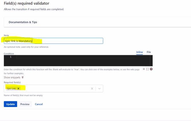

I tried with your suggestion but it is not working, Please see the below screenshot for the same.
Please suggest anything if i am missing.
Steve Long -Evelon-
May 16, 2023
@Ram Raj it won't show a * next to the field (as you're not using field configuration), however if you press 'Create' and try to create the ticket, it should fail as expected.

@Steve Long -Evelon- Will Give a try to create Epic.
Ram Raj
May 17, 2023
Thanks Steve!
It Worked.
