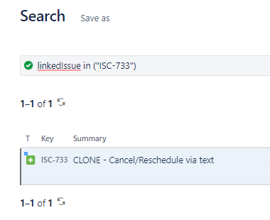

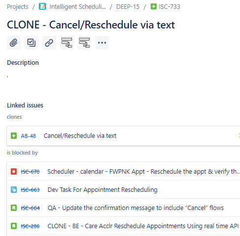

@Fabio Racobaldo _Herzum_ I have few epics in a project and when I use the above JQL to get linked issues under the epic then I'm able to retrieve all those. Now I need to retrieve the linked issues of those epic linked issues. So we have few scenarios like issues are "RESOLVED and few are in "IN PROGRESS". I need your help to track the time spent on those ground level tickets. Below are the Screenshots added so that you can get a clear picture.
When I search through JQL, I'm unable retrieve the linked issues for feature. But that feature has a multiple stories inside it. Please guide me.
@Fabio Racobaldo _Herzum_ I need to search for the linked issues of multiple issues in one JQL . Please help me in that. I tried with the above format adding multiple issues inside it and separating them by comma. But its not working as expected.
