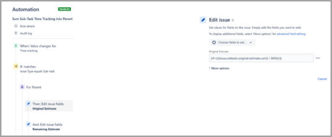

Rule 1:
Trigger: Scheduled (for my tests I ran this every 4 hours, but you could do it on your own schedule). For my JQL, I looked for all open epics in our dev projects.
Branch: For Stories (or other issues in Epic)
-- Action: 'Edit Issue Fields' Set 'Epic Story Size' equal to {{issues.story size.sum}}
Rule 2:
Trigger: Scheduled (I set this to run every 4 hours, and scheduled so that it would run 30m after rule 1). For JQL, I would look at all children of open epics in our dev projects where 'Epic Story Size' is not empty.
Branch: Epic (Parent)
Action: 'Edit Issue Fields' copy 'Epic Story Size' from 'Trigger Issue'
This approach does work, but it's very inefficient and I would guess kind of expensive on Cloud. The main issues I am seeing are:
  1. When editing an issue, you can copy values from but not to other issues.
  2. There is no way to access issues outside of a branch once you are in it i.e. if given a list of epics, I branch to all stories in each epic, I cannot get back to the "trigger" epic.
These two combine to make it necessary to "stash" the summed story points somewhere on the children first. I see that they've implemented the {{issue.subtask.x}} smart value but explicitly say that this doesn't work for epics.
It feels like there's a better way out there, but I haven't been able to see it yet.
