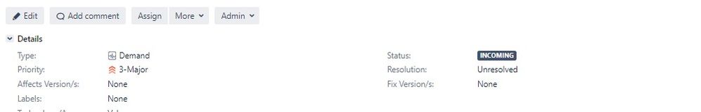

The most common solution for this problem assuming it is not affecting an entire project or instance is to run the Integrity Checker:
https://confluence.atlassian.com/adminjiraserver/using-the-database-integrity-checker-938847667.html
If you're having issues running the integrity checker through the UI (it may timeout due to proxy configuration) it's possible to validate against the database:
Hi M,
Make sure this is an actual transition from that status to another status. Then check to see if there are any Conditions on the transition(s) out of that status.
@Manoj ,
1. First check you have the Issue Transition Permission for the project where you are trying to create a issue.
2. Check if there is any condition on the transition which suppose to visible for you
3. Run the integrity checker for workflow
