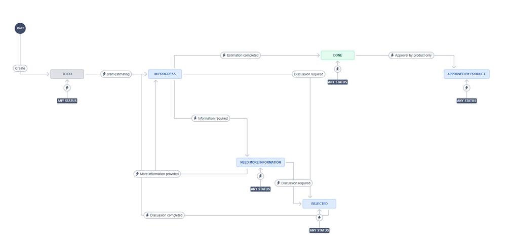

I have setup a Workflow to automate ticket locations based on values specified in the ticket. For example, I have a bunch of tickets sitting in the 'TO-DO' Status column. I then specified a Value to look out for i.e. 'Happy to estimate' (which I added via configuring Project Settings). But even though 'Happy to estimate' is selected, the ticket remains in the 'TO-DO' Status column rather than automatically moving into 'In Progress' Status column.Estimation Workflow.PNG
Danno
June 27, 2022
@VinayPare you using an add-on to do this? I am not familiar with the circled lightning bolt feature or the circled transition labels.

Danno
June 28, 2022
OK, it had been quite some time since I had a Team Managed project question and had totally forgotten about the minimal workflow modification feature.
So, now I would ask that you send a screenshot of the automation rule you created that isn't working. That will help solve the problem.

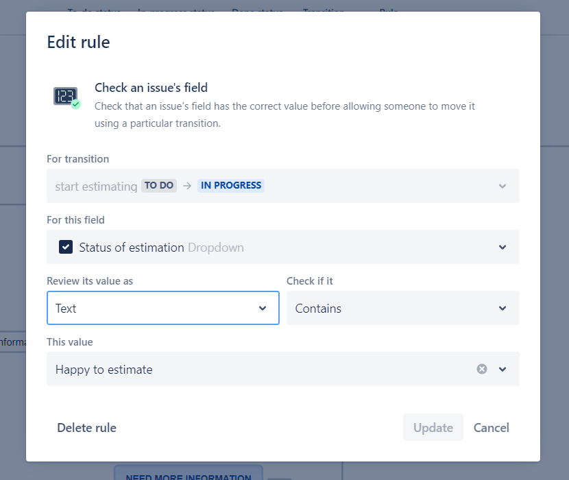

VinayP
June 29, 2022
VinayP
June 29, 2022
@Danno - thanks for coming back to me on  this. I'm attaching one of the Rules that isn't working for me. In the 'Review its value as' field above, I have tried both 'Text' and 'A Selection'.
I'm more than happy to change or create a new Project which is not 'Team Managed' if that will help?
Cheers,
Vinay
Danno
June 29, 2022
@VinayPthis rule isn't going to do what you expected in your first entry. What it will do is keep someone from transitioning the ticket to In Progress if they haven't selected "Happy to Estimate" in the Status of estimation dropdown field.
This rule is a validator in a workflow in company-managed projects.
Since you are using the Standard plan you should be able to access automation rules to do what you want. That is a whole other subject. Unfortunately, the Standard Plan does not allow for unlimited rule runs. You are allowed a certain number of runs/mon. I believe. Given that you have 12 rules in this one workflow alone you will hit that limit pretty quickly I would think.
