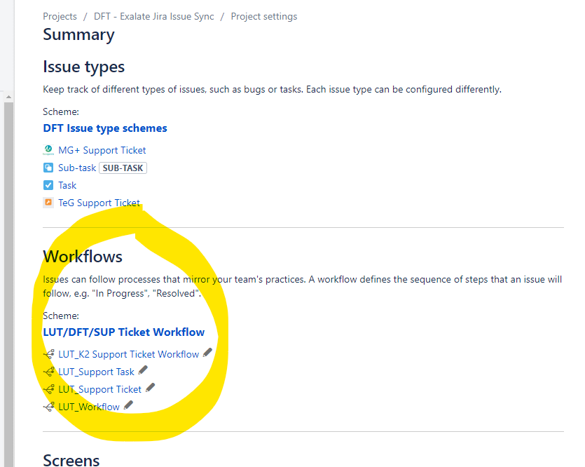

Hi Support,
I managed to create workflows while associating it with a project.
My project summary did show up all as attached, yet when I went back to the ticket, I could found my customized workflow?

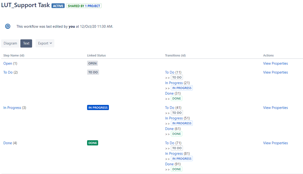

AllenH
October 13, 2020
Hi Support,
thank you for the reply, mine as follows:
1. Yes, we are admin access.
2. yes, every transition does link to another status (plz refer to attached pix)
3. I don't understand this, can you be more specific?
Teck-En
October 13, 2020
  1. Navigate to the workflow which associated to "MG+ Support Ticket" issue type
  2. Inspect any transitions from Open status within the workflow.
  3. Evaluate if there's any specific condition that prevent you from transition to another status. (eg. Only Assignee Condition / Permission condition)

Jane Kao
October 13, 2020
Hi @techenyew
Regarding point 2, is an Open status needs to link to any other status ? Take below as example, does this "Open Status" set up correctly here?  Thank you
Regards,
Jane
Teck-En
October 14, 2020
@Jane Kao Yes, it's needed as Open seems to be your initial status. Without any outgoing transition for open status, that's the reason why you weren't able to transition earlier.
