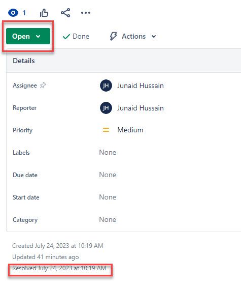

My task is open but shows resolved date and does not appear in board
Junaid Hussain August 14, 2023
How can I see all my open tasks in my board?

The reason your task is not showing up on the board is because the resolution is set which indicate that the issue is resolved. You have to clear out the resolution field (either by adding a transition in the workflow that clears it or create an automation that clears the field) in order for it to show on your board.

Hi @Junaid Hussain
That just the name of the status, the issue itself is resolved. This can been seen by the check mark and resolution beside it "Done"
The status is in statusCategory Done in Jira.

Junaid Hussain August 15, 2023
if it is done, How can i change back to open? I did not market is done. It happened automatically.

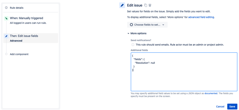

Mikael Sandberg
August 15, 2023
@Junaid Hussain Have a look at this KB, it shows you how to create an automation that clears the resolution field for you. In it's simplicity it would look something like this:
My example is manually triggered from within the issue (the automation would show up under actions on the right-hand side), instead of during transition as in the KB.
