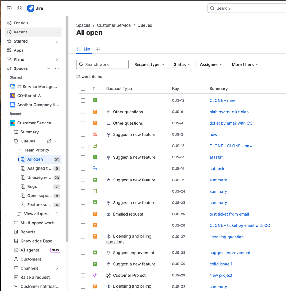

Can you provide a full screen image that shows "my HR Candidate Project on the List as a new Candidate"? Please obscure confidential information. I'm asking for a full screen image of the browser tab so that I can get context on where the data is displaying within Jira. In your initial post you said a "board", but you have also said "list", and these terms are used in Jira for to refer to different ways to view information. I'm trying to ascertain where you expected the information to display so that I can determine the next questions to ask to try to debug the scenario. Here are some examples of views that I have in a Service Space in my sandbox:
Queue listing requests:
Board view within a Service space

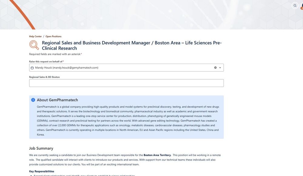

When the candidate applies for the job..whether on our Company Website... or on LinkedIn... they are directed to our Company's website.. the Careers Page.
https://www.gempharmatech.com/about/careers.html
They click the position they want to apply to.. and it takes them to here which is in Jira.  (screenshot below)
https://gempharmatech.atlassian.net/servicedesk/customer/portal/5/create/121

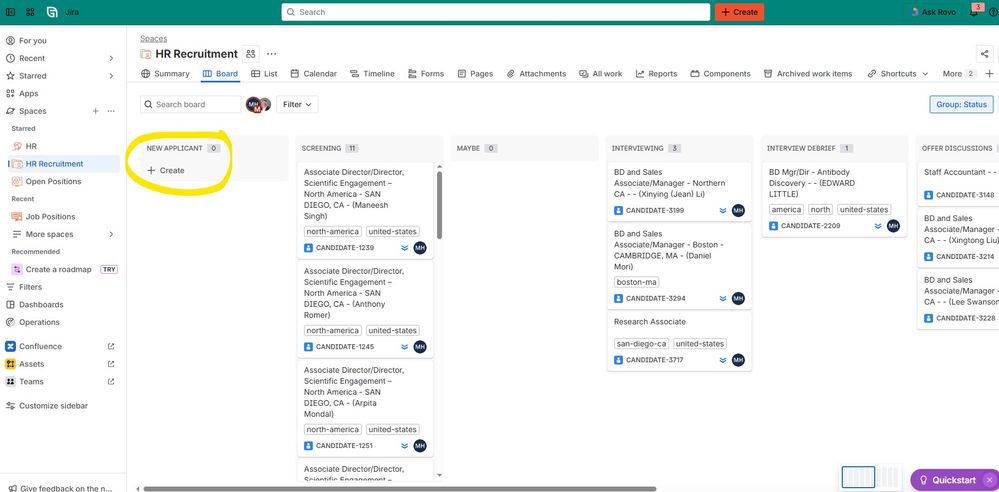

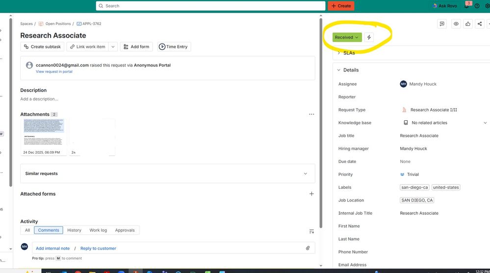

This is the screenshot when I am in my HR Recruitment Space:

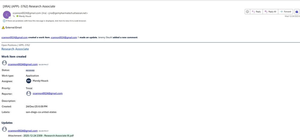

I circled where candidates that had applied for jobs.. used to appear.... now it's empty.. but I am receiving emails from Jira that individuals have applied.  Below is one email I received ... you will notice the Work Type is "Application".
This candidate is not showing in my HR Recruitment... but if I go into the actual email itself.. and click on "View Work Item" at the very bottom... It will take me to their information... where their resume is, etc... and I can review it.... but it won't allow me to choose "Interviewing, Screening, Reject, etc."  It just shows "Received"...

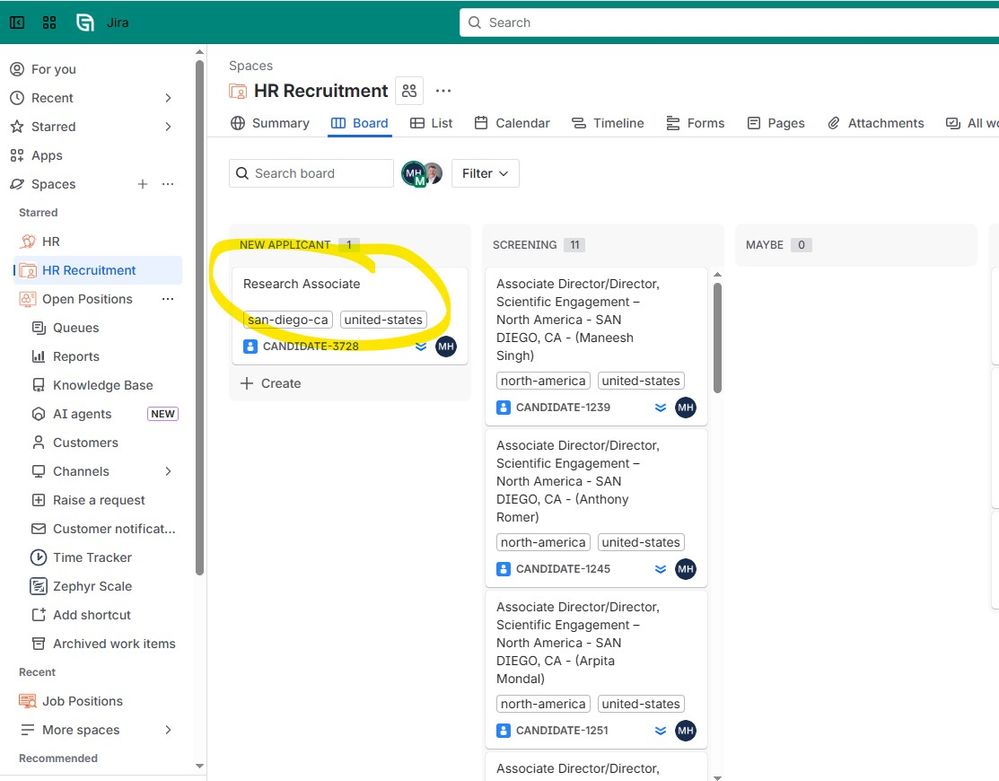

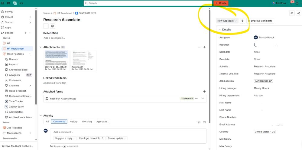

If I want to have this candidate's information show in my HR Recruitment Project I realized I need to click the ... and select "Move"... and then from there I can move it to the HR Recruitment Project.. and once I do that.... then I can go into that HR Project (Candidate).. and the candidate will appear on the Board.. and then I can "Screening, Reject, etc"
Once I move it from the Open Position Project to the HR Recruitment (Candidate) Project.. it appears on the Board... and then I can select and the above picture is where it takes me...
I know this is alot.. and I may not be explaining it in the best way.... but I have never had this issue before.. and I have not gone into any settings and changed anything.. I am the only person that creates jobs and works in the Jira system...

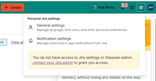

In the upper right corner near you avatar do you see a gear icon? If so, when you click on that what options do you see? That will tell us if you have the administrator access needed to debug this process further.
Mandy Houck
December 26, 2025
Well it looks like I do not have access..... Because the Administrator is no longer with us.. do you happen to have a customer service contact number I can call.... I haven't been able to find a number or way to directly communicate with Customer Service...

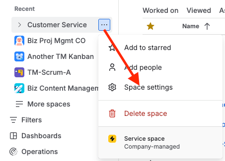

There is still a possibility you have sufficient access.

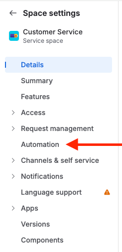

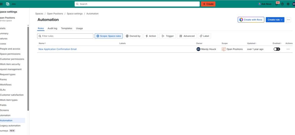

When you click on the ... button next to the "Open Positions" project name do you see an option for Space Settings?
If you have that option, click on it. Do you then see a new panel on the left with an option named "Automation"?
If so, click on that.
If the custom process has been managed by Automation Rules it is possible that the rule was set up in the Open Positions project. If that is the case and if your are an Administrator for that project you might have enough access to address the problem.

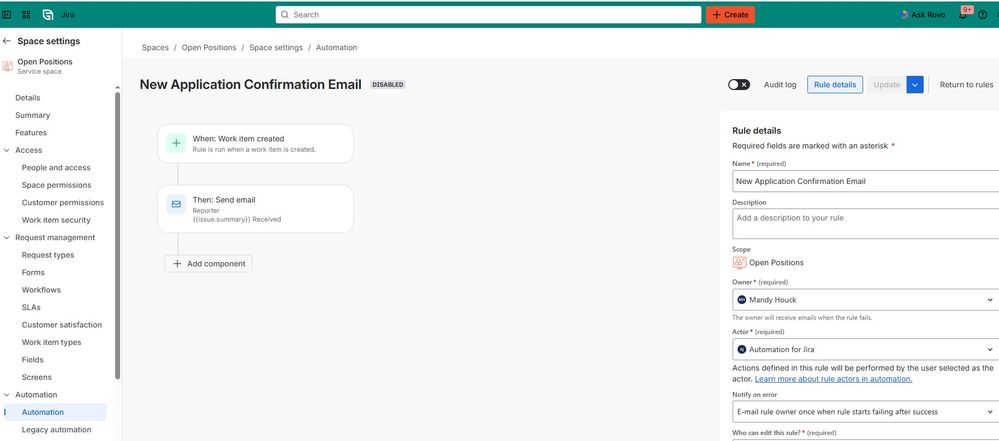

You have been sooo helpful!!  I was able to click "Automation" and this is what pops up.... Is this the screen where I can make the applications that are submitted automatically go to my HR Recruitment Project?   When I click on  .. this is what shows:
Then when I click on "New Application Confirmation Email" .. this is what I see
Trudy P Claspill
December 27, 2025
Unfortunately, that is not the process that transfers to data to your HR project.
The first page shows Automation Rules that are set up to run only for the Open Positions project. It shows just one rule. The second page is the details of that rule; when a new issue is created in the project, send an email.
There might have been a rule that caused the data to transfer, but in fact there is not. Or it was constructed in a way that it doesn't show in this area.
On the first page is another option below Automation named "Legacy Automation". That is another place where rules might exist. Can you click on that and share the results?

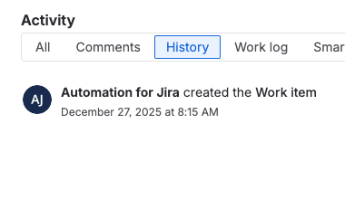

Another thing we can check to try to debug this is one of the older issues that did appear in your HR project
If you look at the History section of the issue and review the earliest entries, if the issue was moved to the HR project then you should see an entry showing that the issue key changed.
Instead of being Moved, it may have been cloned. There would not be an issue key change entry in that case.
You can also look at those early History entries to see who is listed as executing the creation of the issue. That may provide a clue about who was responsible for the transfer process.

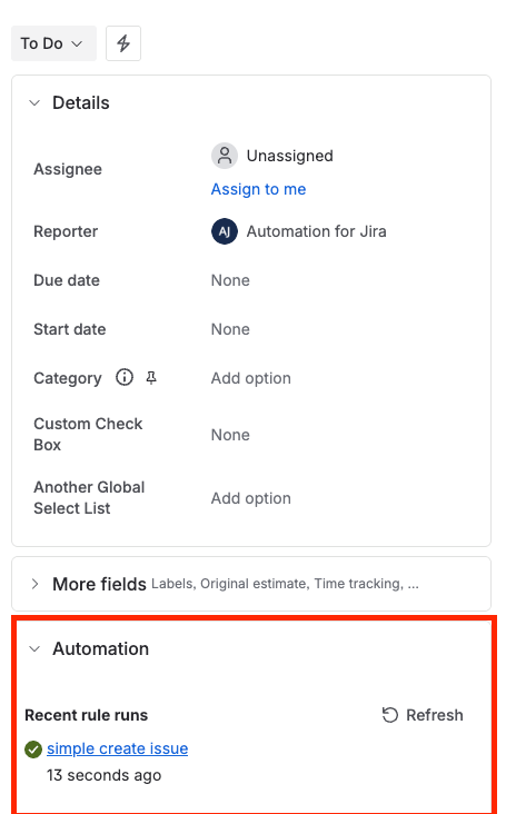

Another thing to look at to see if the transfer was caused by an Automation rule is the Automation panel in the HR issue. When viewing that older HR issue look at the boxes on the right. Expand the one named Automation. Then click the Refresh button in it. Automation Rules that touched the issue should be listed.
The above steps help only if an Automation rule was involved. There are other ways the HR issue could've been generated, but those would take Jira Admin permissions to access.
