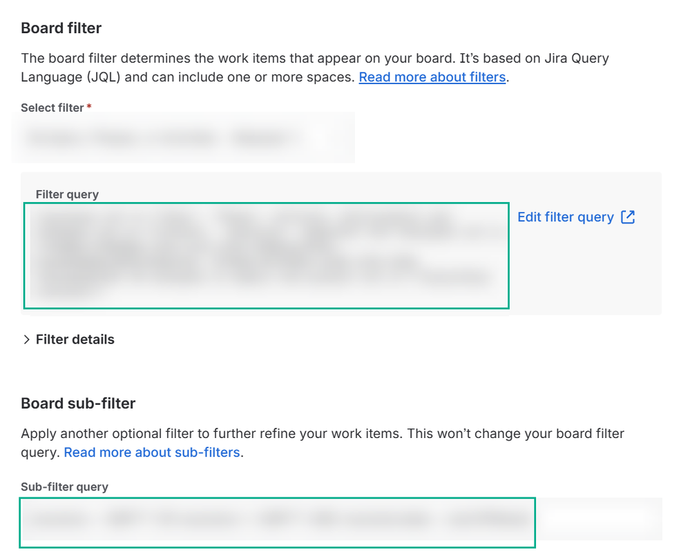

Assuming you have custom boards set up for each of these, can you have a look and see how the filter is configured for your board?  You can check that by going to Configure Board in the ... menu off to the right:
Once in there, you can check the board query and sub-filter query:
Those filters will control which issues appear on the board.  Another place to check is the column configuration to ensure the workflow statuses you're expecting are mapped to the board's columns (Layout -> Columns in Board Configuration).
