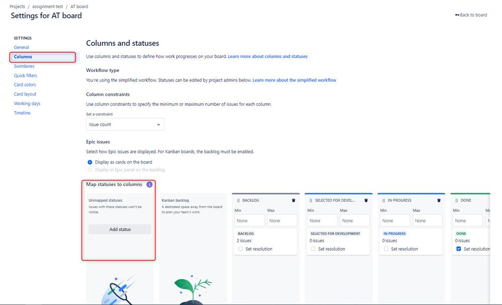

Go to
  • "Configure board"
  • click on "Columns"
and you will be able to see the board columns and the statuses and check if there are status in the "Unmapped "
For refence i have attached the screenshot.

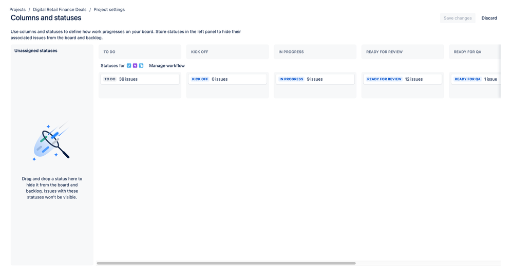

Jessie Pan
February 5, 2024
hey, mine is different than yours, seems I dont have as many options for setting as you have there:
GNarsimhagowda - Empyra
February 5, 2024
Hi @Jessie Pan ,
You might be using Scum board, that is the reason the issue stays in the backlog in order for it to appear on the board you need the issue to be in active sprint.
Thanks.
