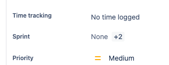

For an issue that was include in sprints that are already Completed, the sprint field will show a count of those sprints.

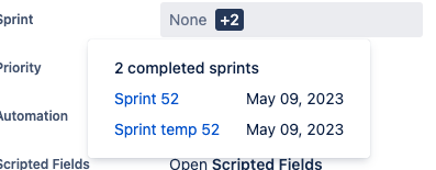

If you click on that +2 you will get a pop-up that shows those Completed sprints.
If the issue was removed from the sprint, then the sprint will not be listed.
