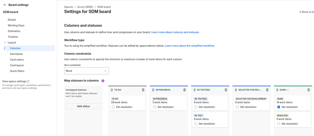

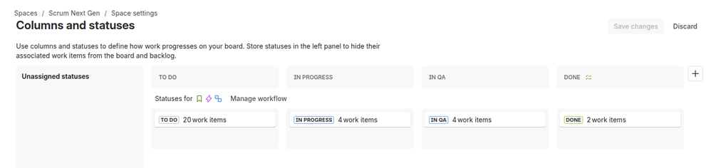

If it is about the Jira's Cumulative Flow Diagram report specific to company-managed spaces (and their agile boards) then ensure it includes all the board columns.
In addition, check in the agile board settings if all the workflow statuses are mapped on the columns - so there are no unmapped statuses.

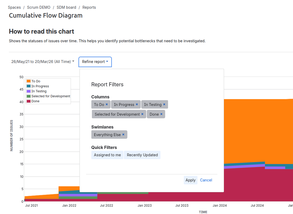

For the CFD settings, have you changed any of the settings / filters in a way that excludes the work item?  One way to check that is reviewing your CFD settings and compare those to an example work item which you believe does not display...comparing the field values.
