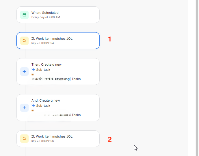

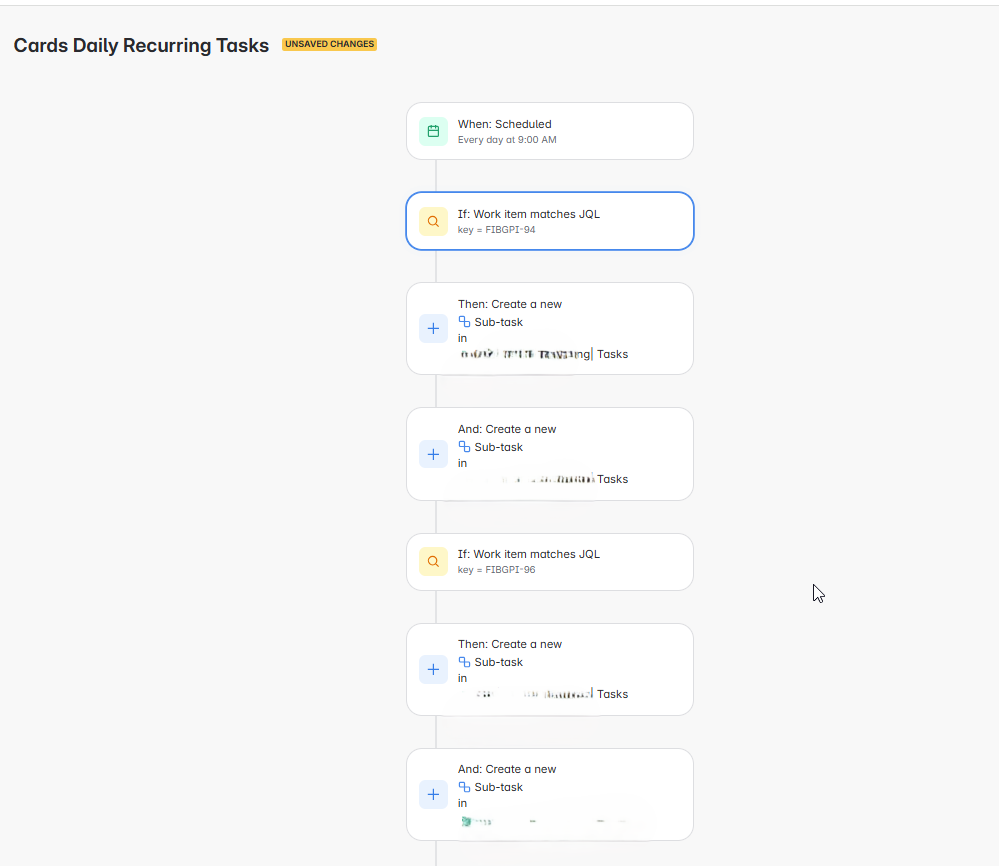

I'm trying to set up a daily automation that creates subtasks under multiple parent issues, but the rule stops after processing the first parent task. Here's what I'm trying to achieve:
Current Setup (not working properly):
When: Scheduled daily at 9:00 AM
If: Issue key = FIB0PT-94
Then: Create 2 subtasks
If: Issue key = FIB0PT-96
Trudy P Claspill
July 7, 2025
Hello @Mohammed_Zeyad
When you use a simple IF condition the rule will stop running with the first IF condition that does not pass.Screenshot 2025-07-07 at 10.40.55 AM.png
If the issue key matches Condition 1 then the Create components immediately following 1 will be executed. When the IF condition at Condition 2 is evaluated, it will fail because the issue key does not match, and the current loop of the Scheduled rule will stop running.
If the issue key does not match Condition 1 then the current loop of the Scheduled rule will stop running immediately.
You will never get a loop of the Scheduled rule that will match conditions 2..n because the rule cannot match both Condition 1 and any subsequent condition.
How do you determine the issues under which subtasks need to be created? Is it always the same set of issues that are getting subtasks? Do you specify the issues using the Execute JQL option in the Scheduled trigger?
Are you creating identical subtasks under every issue, or do the subtasks differ depending on the parent issue?
If the subtasks are identical for every issue, and you are specifying the issues using the Execute JQL option in the trigger issue, then you don't need the IF conditions at all. Following the Scheduled trigger simply add the components to create two Subtasks. Those same two Subtasks would be created for each issue retrieved by the JQL of the Scheduled trigger.
If the Subtasks need to be different for each parent then you need to use the IF/ELSE condition.

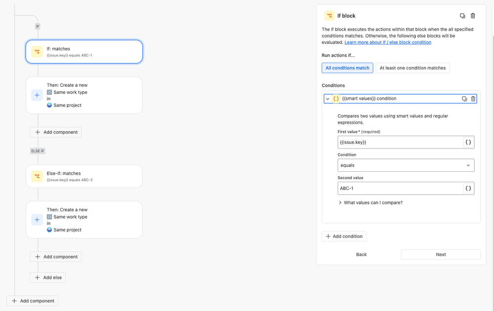

With If/Else the rule checks if the first condition passes. If it does then it executes the components directly below that condition. The rule then skips all the Else If conditions and proceeds with the steps that follow that block.
If the first condition doesn't pass, then the rule check the second condition (the Else If). If that condition passes, then the steps following it are executed, and the rest of the Else If conditions are skipped, and the rule proceeds with the steps that follow after the If/Else block.

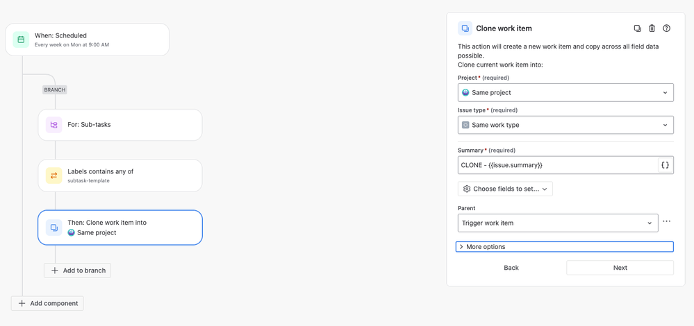

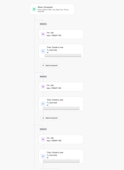

There are other ways to accomplish this with Automation. For example
- In each of the 9 tasks create a copy of each of the subtasks that needs to be created daily and add a label to it like "subtask-template"
- Create a rule with a Scheduled trigger and a JQL to select the 9 tasks.
- Add a Branch - For Each Sub-task
-- Condition: If Labels contains-any-of subtask-template
-- Clone Issue

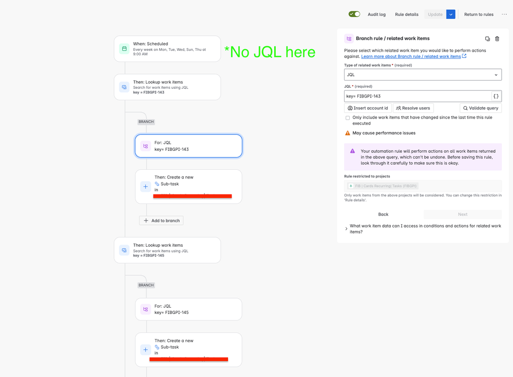

Mohammed_Zeyad
July 15, 2025
Hi @Trudy P Claspill ,
Just wanted to let you know that I've tried this one out today and it seems to be working as expected. do you think that's the optimal way to do it ?
Trudy P Claspill
July 15, 2025
There is no reason to have the Lookup Work Item actions. You don't appear to be using the results in any way in the other components of the rule.
You said previously that you have 9 tasks each of which has 2 - 4 subtasks. With the method you are showing above (assuming you will eliminate the Lookup Issue actions) you will have
9 branches
18 - 36 Create Work Item components
For a total of 27 - 45 components in the rule.
There is a limit of 65 components in a rule, so you will remain under that limit.
If you anticipate adding more Tasks to the Epic or more subtasks to the Tasks, you will need to be aware of that limit.
Branches run in parallel. You cannot rely on the branches executing in the order you have placed them in your rule.
As long as neither of those is a concern I don't see why this wouldn't work.

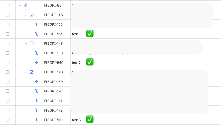

Mohammed_Zeyad
July 15, 2025
Actually, you are right; the lookup is not necessary, and removing it still does the same thing. As for the order of execution, it's not important. Thank you again for the input, @Trudy Claspill
Screenshot 2025-07-16 at 9.46.59 AM.pngScreenshot 2025-07-16 at 9.42.41 AM.png

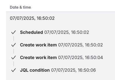

Mohammed_Zeyad
July 7, 2025
Hi @Gor Greyan
tired it but still stops excuting after the first part runs

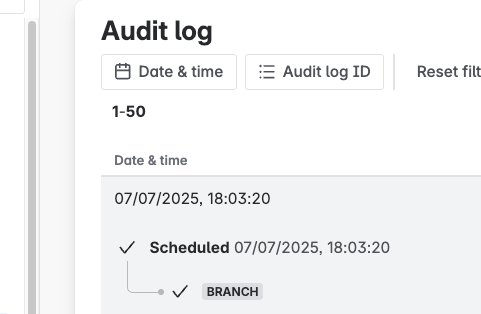

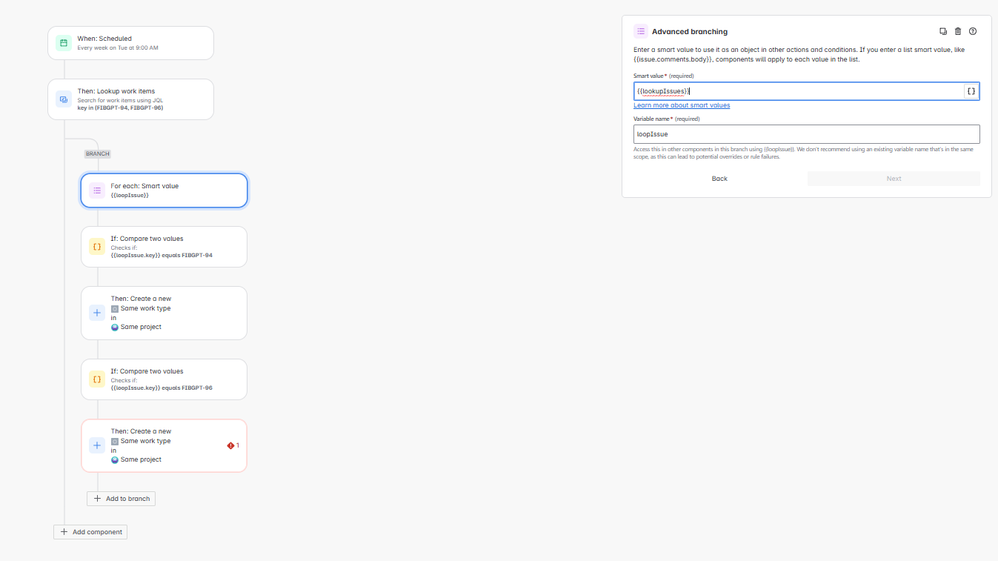

Try to add a “For each issue” Branch:
After the trigger, add a "For each: Issue" action.
Inside the branch, use the If/Else condition.
Scheduled Trigger (JQL: key in (...))
|---> For each issue:
|---> If issue = FIBGPT-94
| |---> Sub-task A
| |---> Sub-task B
|---> If issue = FIBGPT-96
|---> Sub-task C
|---> Sub-task D
Mohammed_Zeyad
July 7, 2025
Thank you, but still runs only once

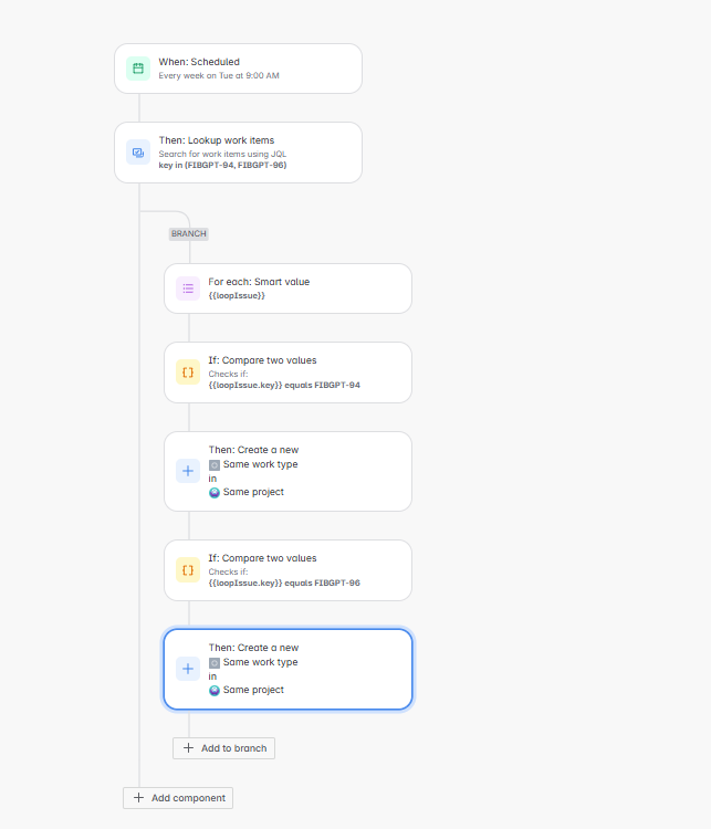

Gor Greyan
July 7, 2025
Hi @Mohammed_Zeyad
Thanks for the answer.
Please try this solution.The second image is the For Each branch comparison, what to write there.
Trudy P Claspill
July 8, 2025
@Gor Greyan
Have you tested that yourself with issues that should match a condition beyond the first one?
I have. It doesn't work. Please see my answer explaining why it doesn't work.
Gor Greyan
July 13, 2025
I didn't test it in my project, only create the logic.
Thanks for the explanation.
I think it will also work with multiple branches. For example, create one branch for the first condition, then another for the second one.
What do you think?
